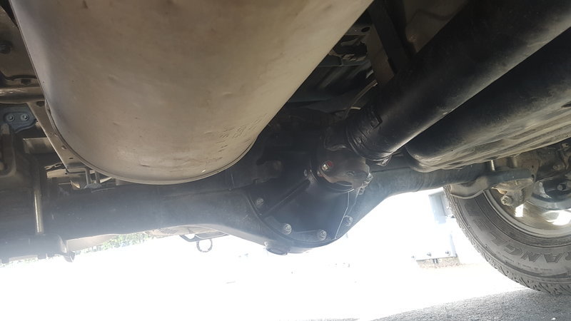

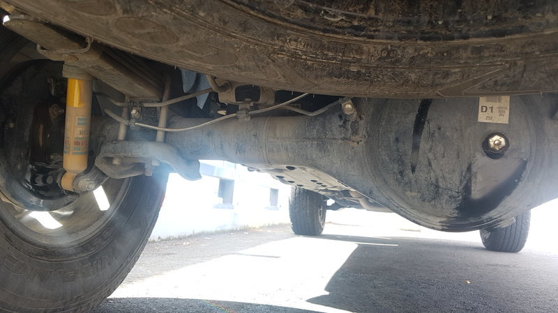

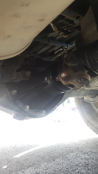

    looks to me like they replaced the diff and all seals on the rear axle.

    Re-upload the photos

    Are they Working now? I linked the first ones from Imgur. These ones are uploaded.

    Yes they are, Thanks
    Have u noticed any improvement? Still makes noise?

    No noise yet. Only about 200K on it so far. I'll let you all know more as I drive it.
