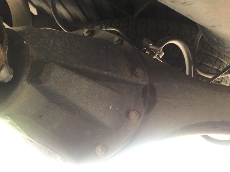

    Now 7 days since you were there. Today had mine in for 1 year /16,000 k Service at Jim Pattison automall. Had a couple other small issues fixed at the same time, while I was getting the service. Pointed out the rear diff seaping in a couple places and they said no problem and they would check it out as well. Long story short is, it seems they have no parts to repair it with currently. But they do confirm the very mild seap and will repair when parts available. Can't really ask for much more than that. If it stays at the current rate of leaking it would be years before I would have to worry about it. The two small spots where the two housings join is the leak with another small spot on the other side. Disregard the splattering of the other grease spots. Caused by them being a little over zealous with the grease gun on the u-joints. I did them once when I first bought the truck and it never produced splatter like that.

    Are you kidding me....:eek::eek::eek::eek::eek::eek:.........Caused by them being a little over zealous with the grease gun on the u-joints.
    I cannot believe it.....a DEALER...."over zealous with a grease gun...?? About time...!!! :thumbsup::thumbsup::thumbsup:

    On your service work sheet, on parts consumed, did it list they used a new rear crusher washer on fill plug of rear diff?
    Secondly even before this whole recall started there have been a few threads on guys who changed rear diff on their own at home only to find the rear diff was low. 1/2L low if I remember correctly.
    Seeing a leak and calling it a leak is cool... but work order should atleast reflect someone stuck their finger in there to measure level.

    Totally agree with this statement... I checked mine and it was 1/2 liter low.....front diff down a cup also...!!

    Did you not read what I wrote????
    They have not even started to repair the seaping in the rear end yet.
    I understand the procedure as I'm a mechanic with my own shop. Anyone wants to visit me in Portkells is more than welcome. I Always have cold beer in the fridge. All drivetrain fluids were checked and were fine when I personally checked them. The Zerks required 3 pumps when I bought the truck, as only the standard manufacturing/assembly grease was in the uni's, which is par for the course on a newly assembled vehicle. When you pump too much grease in the zerk on a universal it will push out of the seal cups. So when spinning at the rate a driveshaft does when running down the freeway , will splatter all over the F'in place. Hence makes for real the sloppy grease job splattering results. Bonus being less places to rust. ;)

    I have to say, that much grease splatter make me wonder if they actually pumped any grease into the zerk or if they misconnected and just pumped grease around the zerk instead.

    No. They just pumped so much grease into each zerk, that the grease has blown out BigTime, from the universal cap rubber seal cups. 4 on each universal. Oh they got more than enough grease into the uni's. Now its all over under my truck
