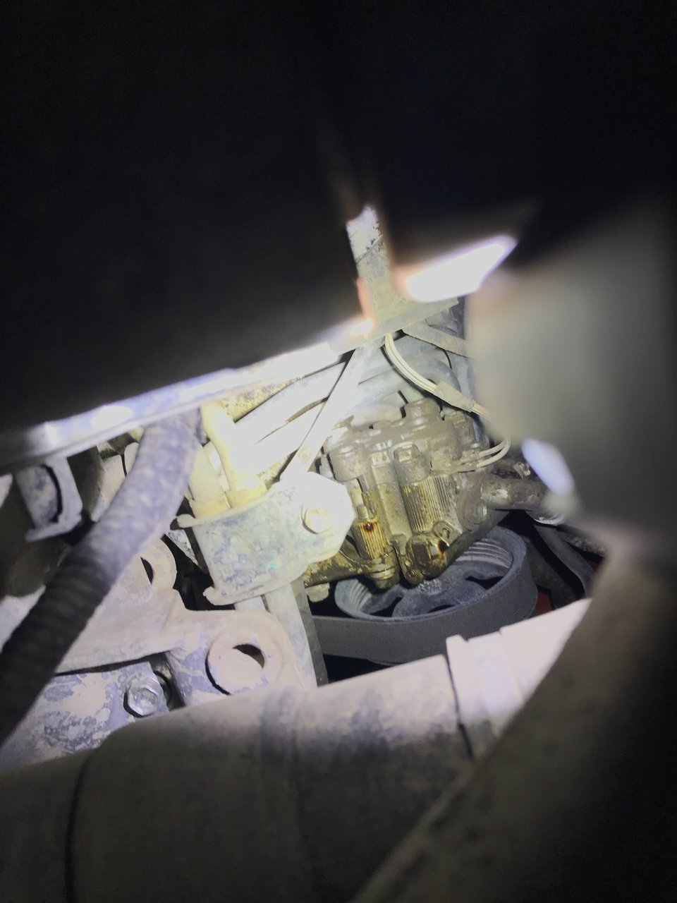

    Thought I'd give the other Canadians a heads-up:
    My 2016 @ 35,000km has come down with the leaking timing cover issue discussed in a couple other threads. I noticed oil accumulating on the bottom of my power steering pump while I was underneath doing an oil change a couple weeks ago. Took it into Stampede Toyota in Calgary and they said it was leaking down from the timing cover. 4ish weeks to order parts from Japan, and then 1-3 days to install, all under warranty of course. Said it's the first one they've seen with this.
    Keep an eye out for something like this next time you're underneath. Power steering pump is your leftmost pulley when looking into the engine bay from the grill. This is looking up from underneath.

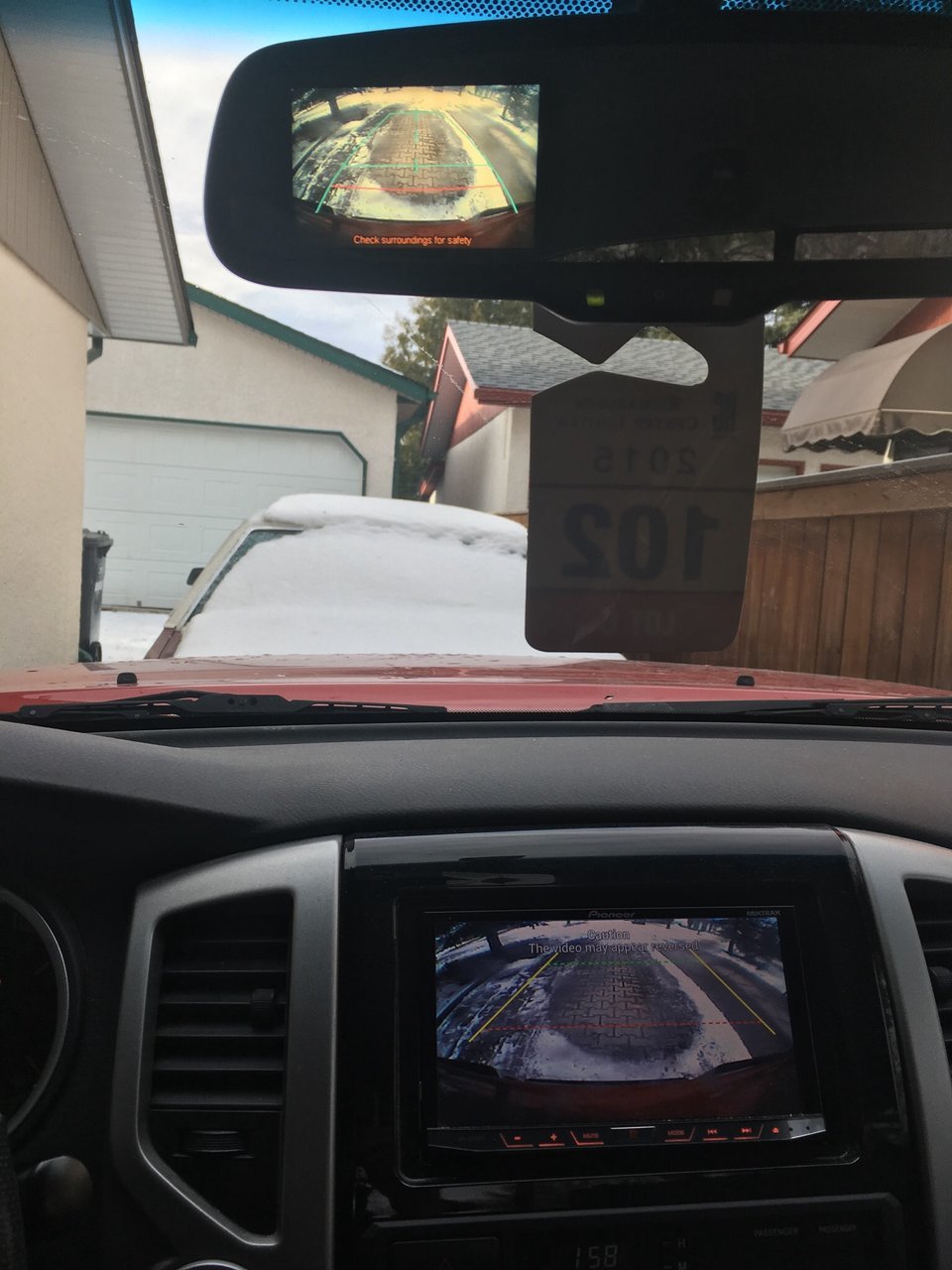

    I don’t get you. You have two rear view cameras showing the same thing?
    A rear dash cam shows a totally different angle and range of image.

    I understand, right now it's two backup cams, but it doesn't have it be. The large display offers greater proximity, the mirror is for focused for very close views. It's certainly not a camera like a GoPro & like.

    Two cameras with the same picture. Seems redundant to me.
