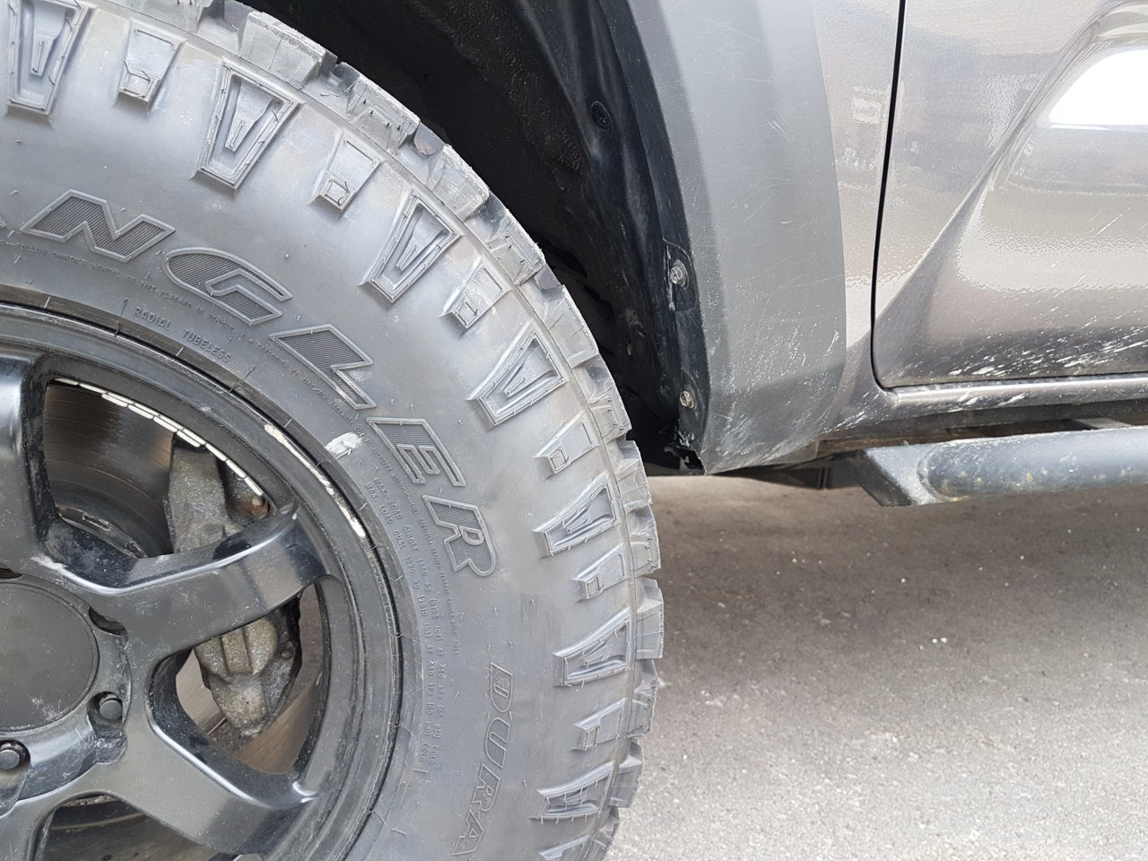

    @CdnTacoma No lift, 265/70r17 Falken At3w on Sema 4runner rims. Rubs on full lock going over curbs and ruts, trying to track down where it's hitting to stop it.

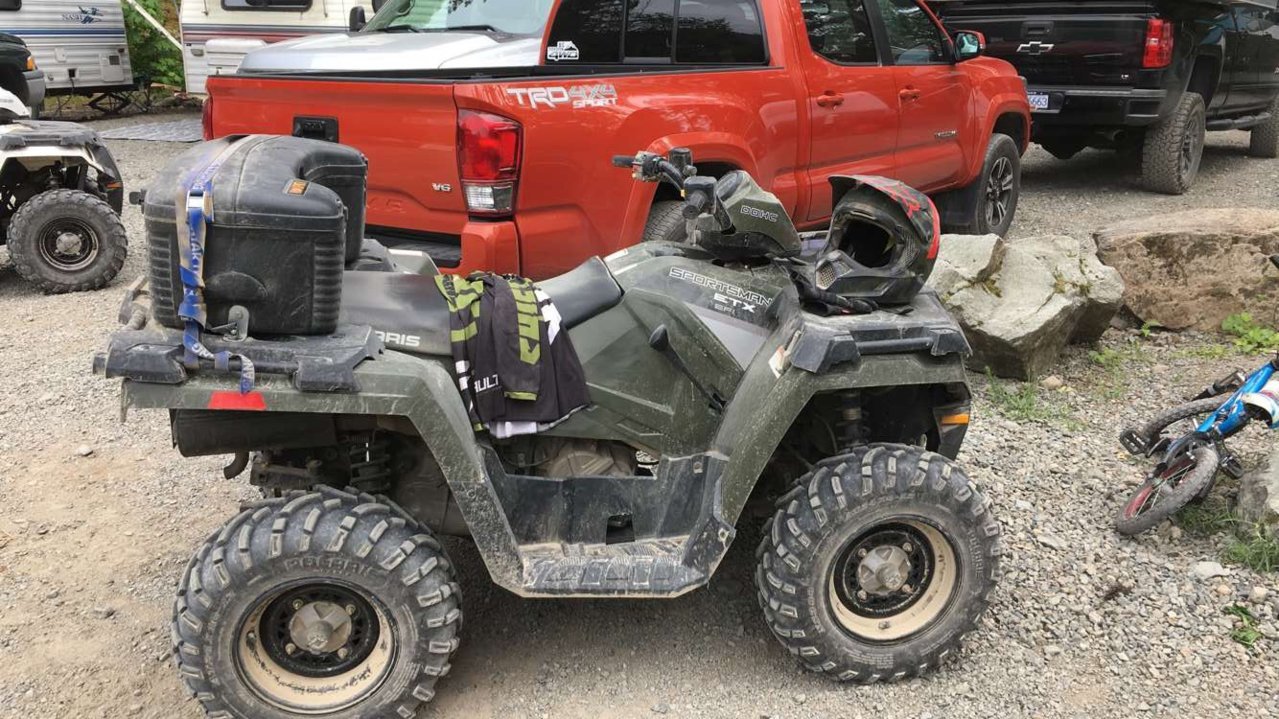

    FE6E0042-3058-48A6-BB9F-45EB5C148D22.jpg B80C3C2F-5FEA-4DA3-8158-0F7CAF4E78A5.jpg
    These two machines took me some places this May long! Love the Tacoma I’ve had for two years now and my bad ass Polaris I’ve had for one!

    Plastic rub or metal?
    It's probably right by where the mud flaps rub . This is where my 265 70 17 rubbed when I had them .
    Just heated it up with a heat gun and pushed it back. No more issue
    Pic is my 285 so a lot has been cut off. But check there I'm 90% sure that's where you would be rubbing
