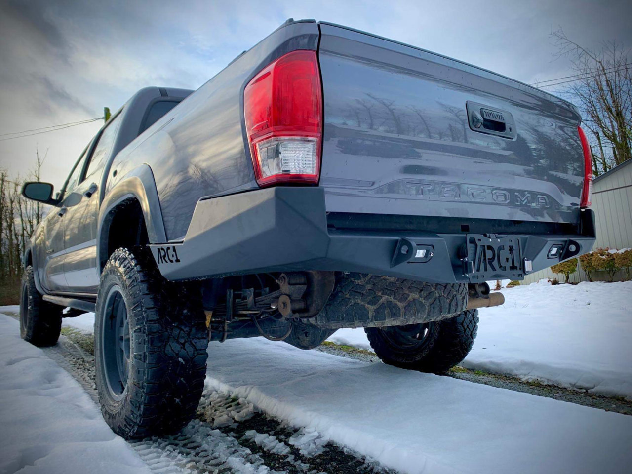

    Any chance that ARC1 rear bumper will work with my radar BSM? It looks like tits, I need one.

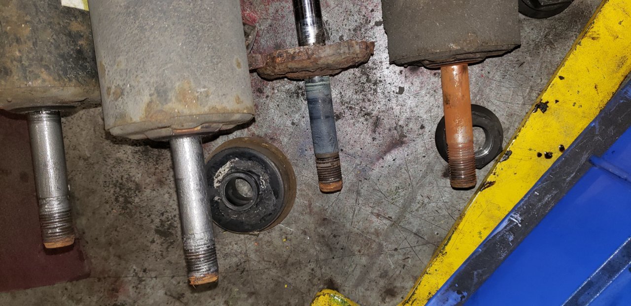

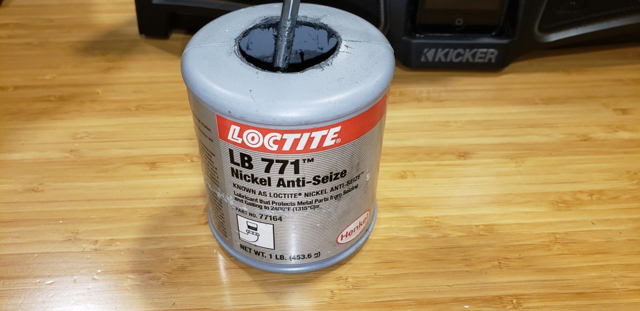

    I never assembly without a liberal coating of neversieze compound of some sort. I work on equipment that takes a shit kicking daily and shocks are replaced every couple of years. Neversieze is the difference maker!
    Left are neversiezed, the right were not. A pain to remove even with an impact gun.
    I go through a bottle a year at work.
