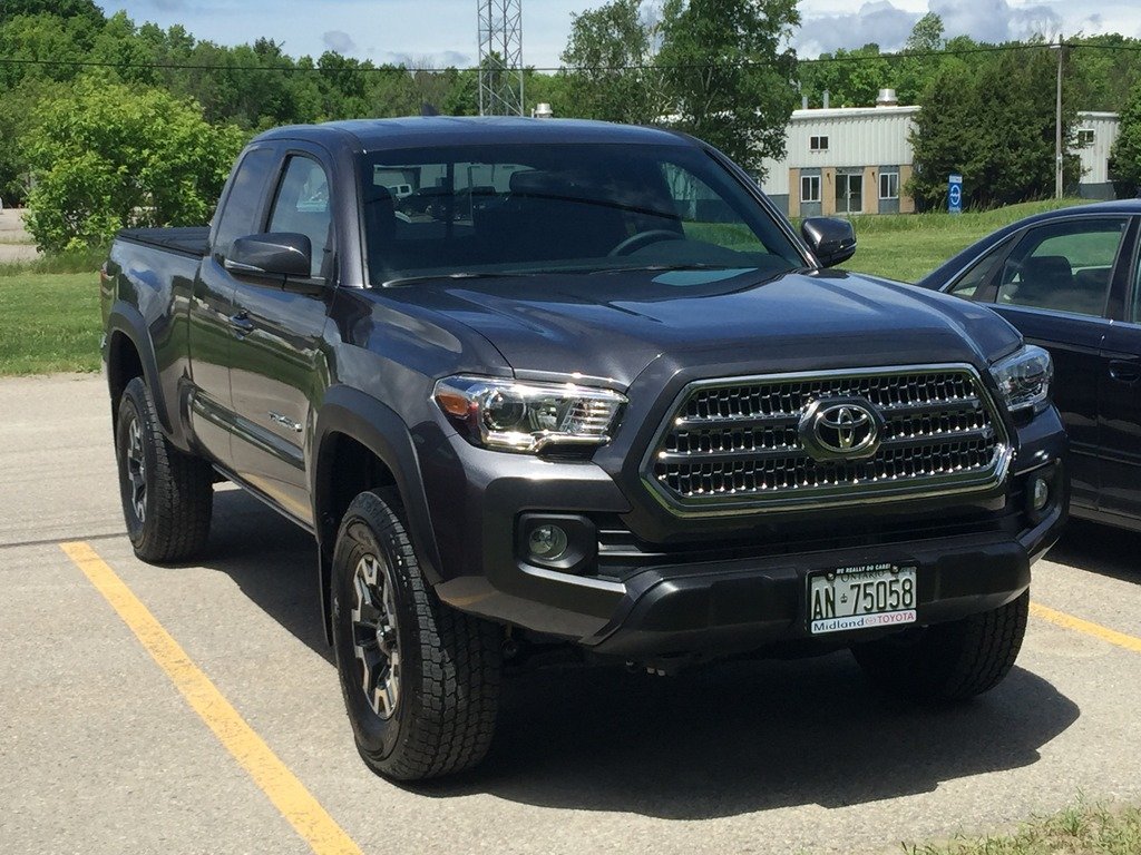

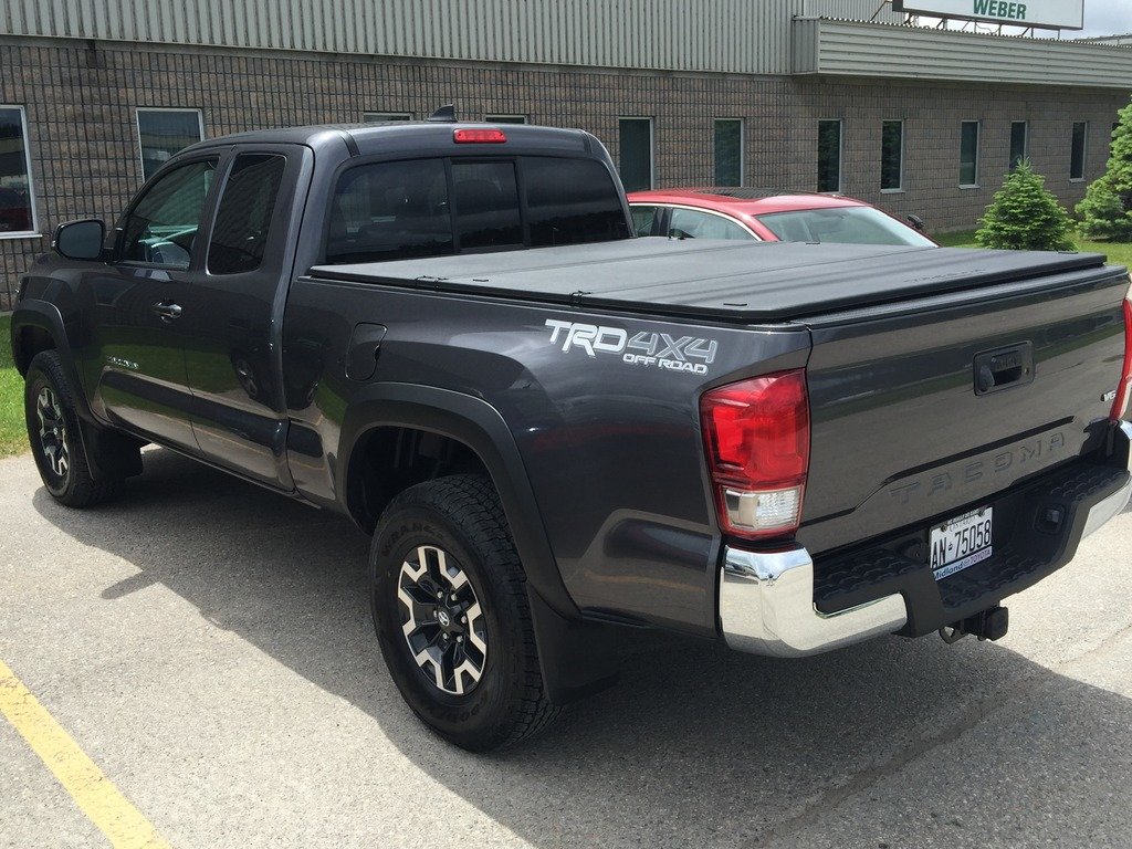

    Hello Fellow Canucks,
    Thought I would put my first post in the Canadian Thread.....
    I bought my 2016 Tacoma Off Road in early June, and I'm really loving it. Judging by the automatic trans comments, I'm also really glad I went with the manual 6 speed trans.
    Here's a few images:
    Looking forward to learning more about the truck, at least the good stuff anyway.
