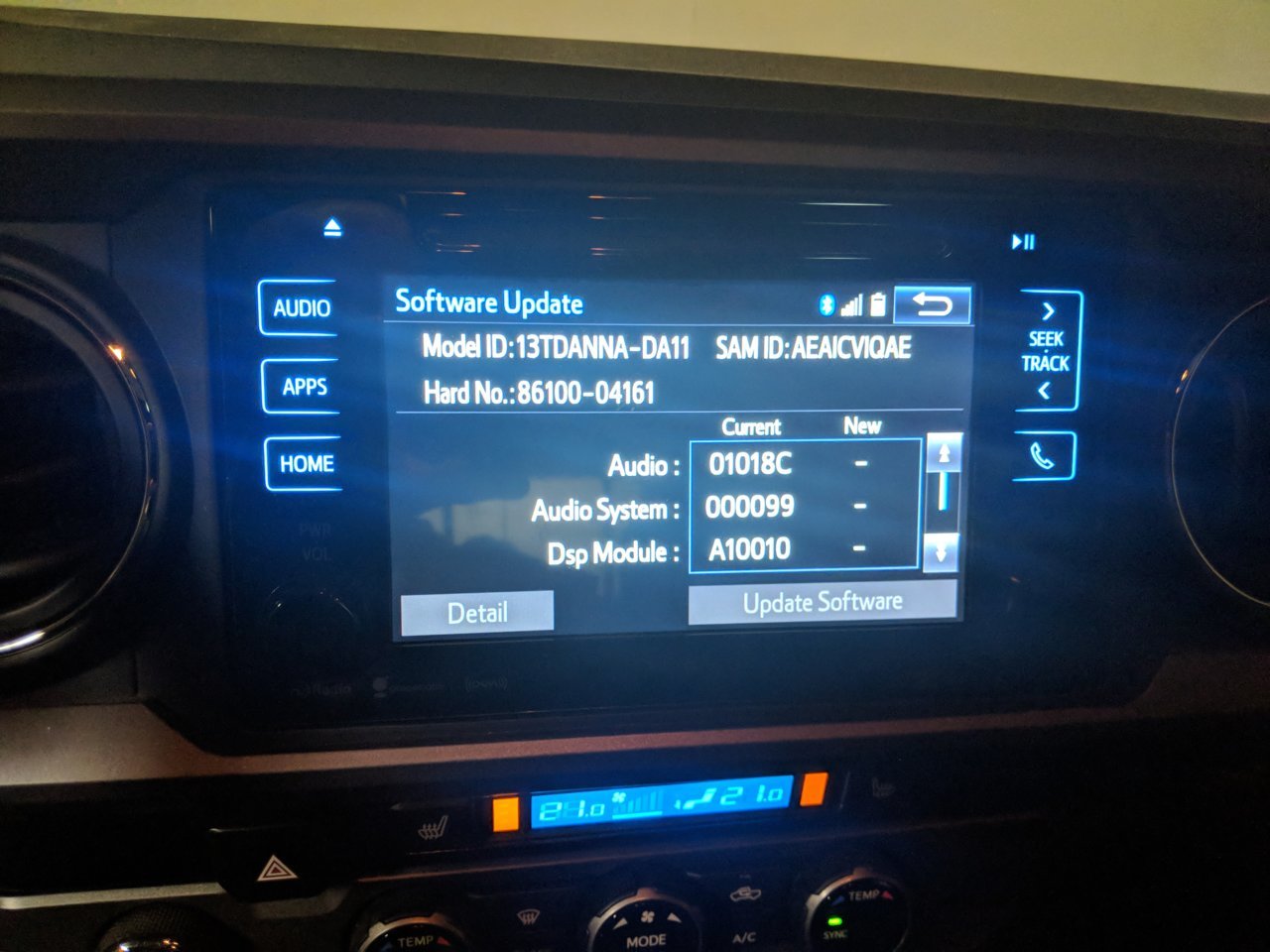

    How did you guys get this to work? When I input the hardware no I just get an error on the website saying it's invalid.

    Post a pic of the number and I will try it for you

    in the bottom righthand corner of the radio, there are some small numbers in white. Those are all you need for the update. They are printed on the radio. Sorry can't see them from this pic

    Crap your right, didn't notice as dark in the garage. Will apply the update now, thanks.
