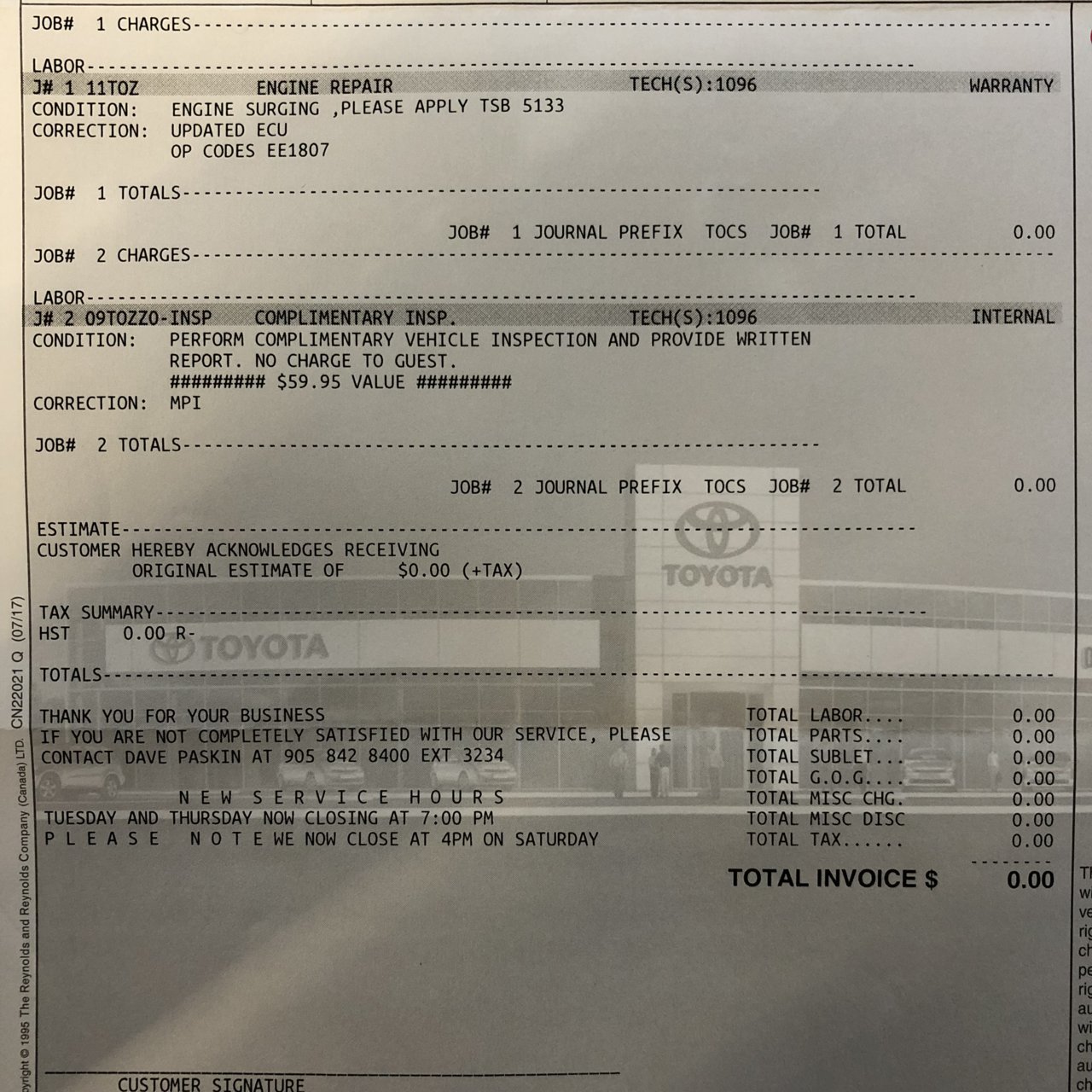

  12. Sep 21, 2018 at 6:31 AM
    16yota
    16yota Well-Known Member
    Aug 7, 2016
    #193992
    66
    Ontario
    2016 TRD Sport Metallic Grey
    Slowly ongoing
    Had mine done this morning. The service rep didn’t know anything about it but I had the paperwork to go through with him. Took about 40 mins including car wash. Only had one drive so far but didn’t feel or hear any surges. Here’s the paperwork from Toyota:
    Joe23[QUOTED] likes this.
  13. Sep 21, 2018 at 7:52 AM
    Joe23
    Joe23 Canuckistikian
    Oct 5, 2015
    #165909
    11,299
    The Great White North
    2017 TRD Off-road DCSB
    Ok very similar .
    And I've since noticed a huge difference .
    The day of was whatever but now much much better
