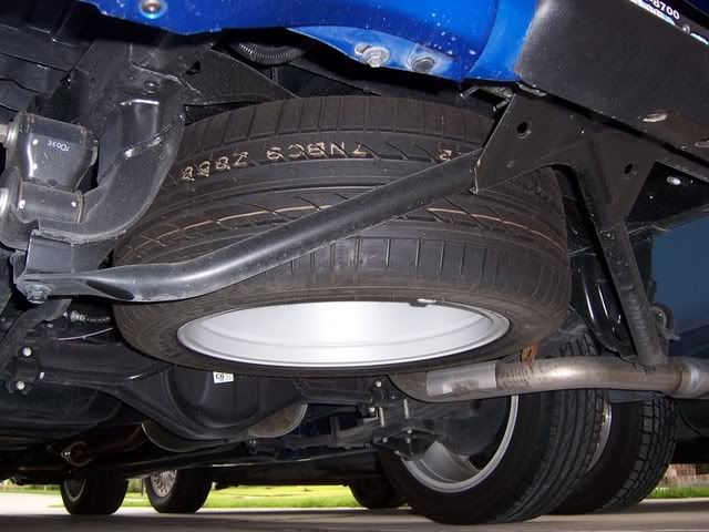

    Has anyone ever thought of or tried to build an x-runner like "x-brace" for the back end of a 4x4 to reduce the "hopping" that they do when the tires are slipping?
    I mean like this;
    http://i62.photobucket.com/albums/h103/Grumpy_G/100_9581.jpg
    So what it looks like, is that they've added a cross member up right ahead of the back bumper, and connected down diagonally to the lowest point where the rear leaf shackles hook on. The idea being that it would prevent the frame rails from moving relative to each other in a vertical direction -- keep them parallel.
    From the pictures, it looks like the x-runner frame has an extra bracket welded on there to bolt the brace, but the 4x4's at least have a big hole at the bottom there where we could drop a bolt through.
    My main concern is regarding spare tire clearance.
    I'm going to have the leaf springs off in the next few days since one of mine broke (replacing with EMU springs with 3rd down removed), so I'm thinking of dropping bolts into those holes while I have clearance.

    Do you mean axle hop when trying to accelerate in a straight line? The X-brace on the X-Runner won't help with that. The X-brace just limits side-to-side motion of the rear shackle mount when cornering hard.

    It actually hops because the frame moves -- it isn't just the axle. If it was just the axle, then the shock absorber would be able to dampen it.

    Nope. It hops because leaf springs are not able to resist axle wrap. The opposing-shocks arrangement on 2nd/3rd gens are better at this, but can only do so much. To get rid of it, you'd need a traction bar / torque arm. Budbuilt and ATO make them.

    I have traction bars. Due to axle wrap. 4x4 and PreRunner leaf springs, especially before the OEM leaf upgrade, were/are a very soft spring rate. XR springs are much stiffer. Reduced the axle wrap/hop nearly to nothing.
    Like the others said, the x-brace is specifically for frame rigidity. To improve handling by reducing frame flex. Coming from the realm of the XR performance world, they still had the "hop" you describe. They still needed to add traction bars to alleviate the wrap.

    You wanted hop. The wrapping in the video is what induces the hop. Torque causes the hop. Uneven terrain amplifies the hop from the axle through the suspension, into the frame and bed. Where it is what you see. Then end result. Not the root of the reason.
    Stiffeneing the frame doesn't correct the source. It will just isolate it more.

    It's the other way around. The frame is moving b/c the axle is hopping up and down. You can stiffen the frame all you want, that won't stop the wheel from hopping.
