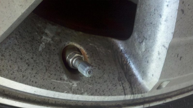

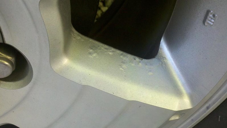

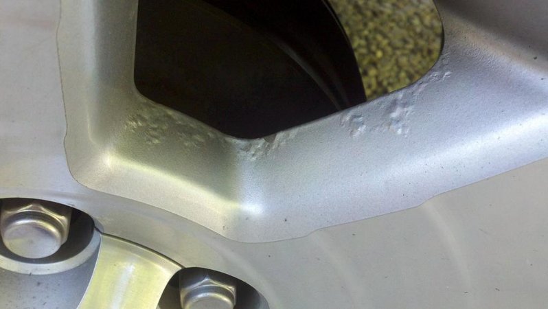

    I've got an 07 double cab i just bought. all 4 wheels have bubbling issues. the dealer told me that there must be pinholes in the finish which caused water to get under the finish and make it bubble. they said they could do nothing about it due to my 65,000 miles. i'm wondering after reading all these wheel painting threads, can i sand, or sandblast, the wheels and either paint them myself or get them powder coated, and still have a quality finish?? i'm really trying to not have to purchase new wheels. any ideas or solutions would be great.
    heres some pictures.

    Sand then paint/powdercoat. It'll be cheaper painting them yourself.

    Very common on the trd sport wheels, unfortunately.

    Very common on the Off road wheels as well.
    Crappy toyota and their coatings.
    Honestly yours are not that bad yet. You can easily get those power coated.
    Some have been lucky enough to complain to Toyota directly and to their dealer so they would refinish them even out of warranty. Best of luck.
