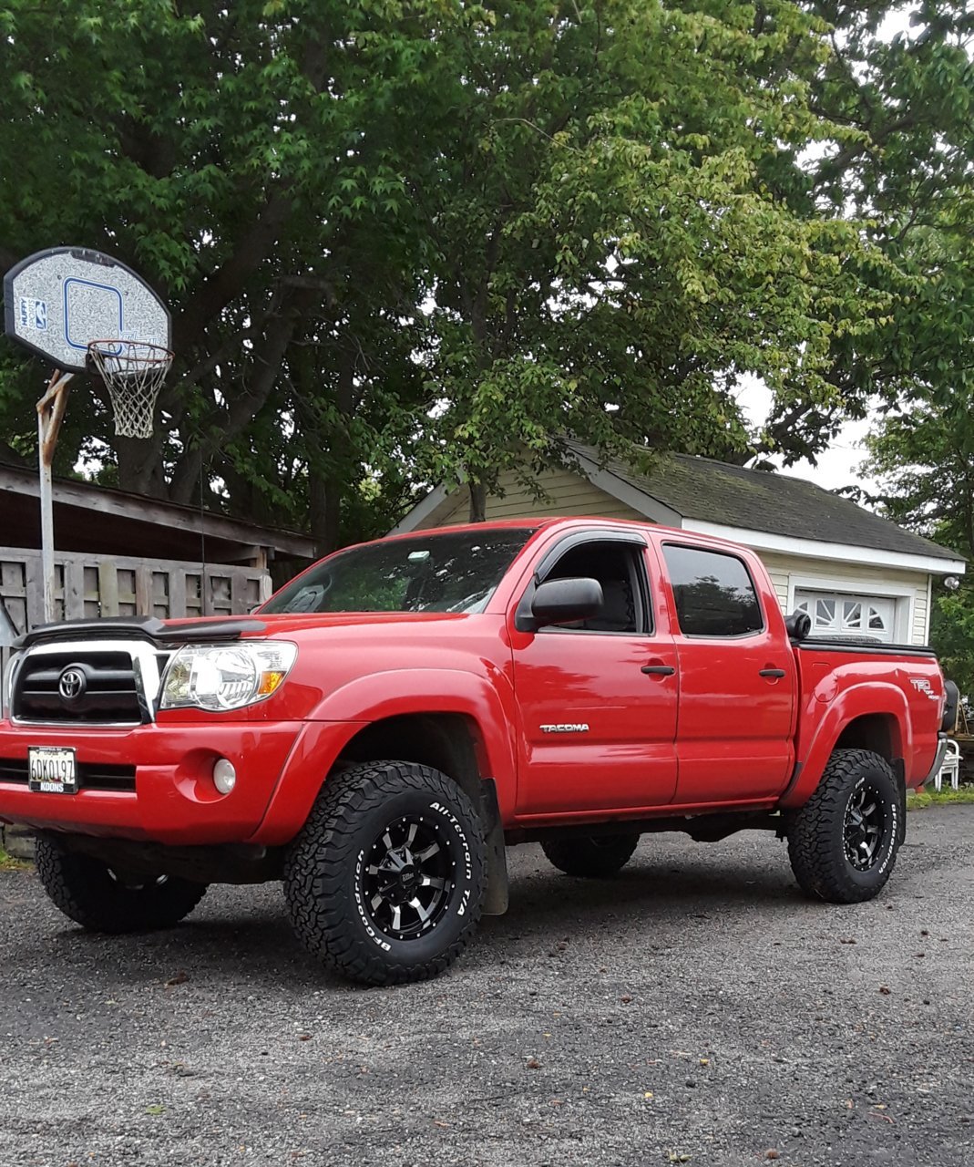

    20190624_073159.jpg This is 2.5 setting and 2 inch block.

    That.is.absolutely.bad.ass.
    Thank you for the share man.
    Could you please tell me what wheel/tire setup you have?
    I am going to be running stock 17s with some decent all-season (pretty meaty) until I can hopefully grab some BF-All Terrains.

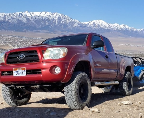

    If you are going to lift it, err to the higher side that way you don't wish you had gone more. Mine are on the highest setting with aftermarket springs and Icon progressive add a leaf in the rear.

    The wheels are moto metal mo970 16x8 0mm offset, tires are 265/75/16 BFG all terrains.

    Wheels are Pro Comp 16x8 with 265/75R16 BFG KO2's for mine.
