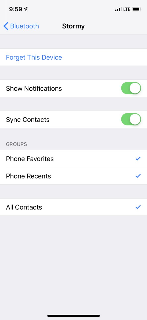

    if you go into the Bluetooth on the phone and pull up the pairing to the truck make sure the button for pushing notifications is on.
    mine wouldn't show texts unless that was turned on

    Updated software, no problem, verified Bluetooth settings on connected/paired (12.1.2) phone were correct, no go!
