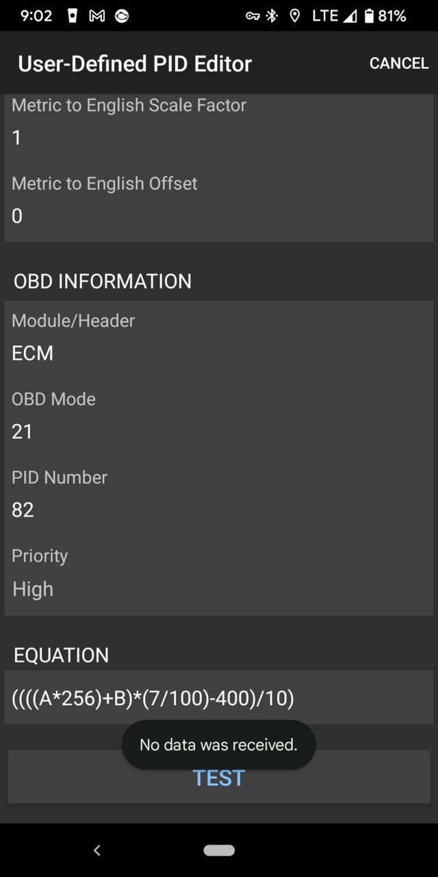

    I've tried two different scanners and two apps (OBD fusion and the OBDlink, which looks exactly the same) but both scanners/apps will give a "no data receive" error when entering the custom pid. I contacted OBDlink customer support and their first question is do I have a trans temp sensor. I'm assuming yes given that so many here have reported using a scanner to monitor when towing. Is there any reason to think the 3rd gen doesn't have a sensor?
    If the sensor exists, is there a way to know if it's working?
    If it exists and is working then I must be doing something wrong. This is the info I entered for the custom pid.
    English units = F
    Min value = 0
    Max value = 300
    Metric to English scale factor = 1
    Module/Header = ECM
    OBD Mode = 21
    PID Number = 82
    Equation = ((((A*256)+B)*(7/100)-400)/10) Also tried for converter temp ((((C*256)+D)*(7/100)-400)/10)
    Also tried C and D for the converter temp. Always get this error. Any thoughts? Thanks for any help.

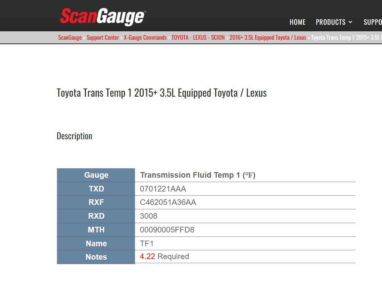

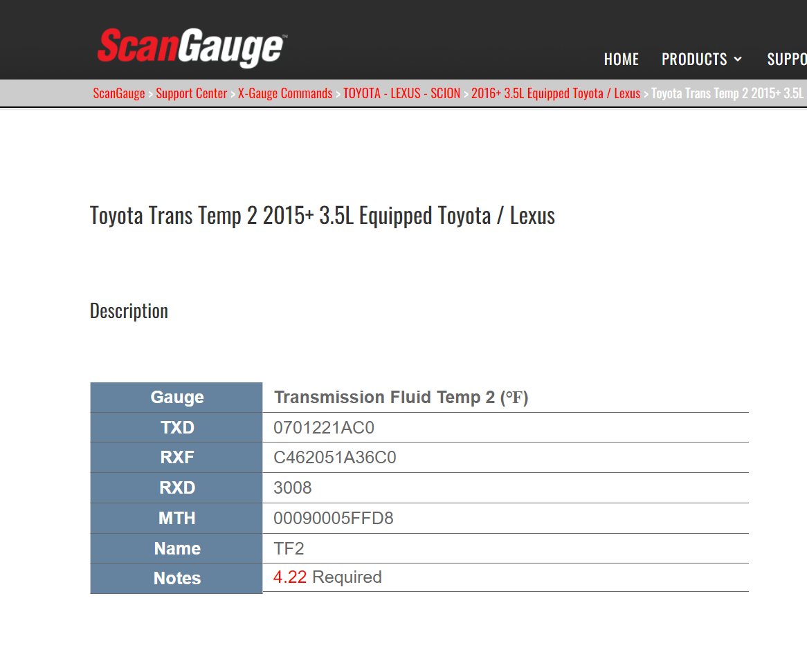

    Frustrating. Sorry to hear that. Your setup looks much different than my SC2 as I just had to manually enter 4 sets of codes then name my custom view (took about ten minutes to plug in all the codes for TF1 and 2).
    Did I link this TW thread in your other thread? If not here it is and you may want to chime in over there. It looks like that is a dedicated thread to your application.

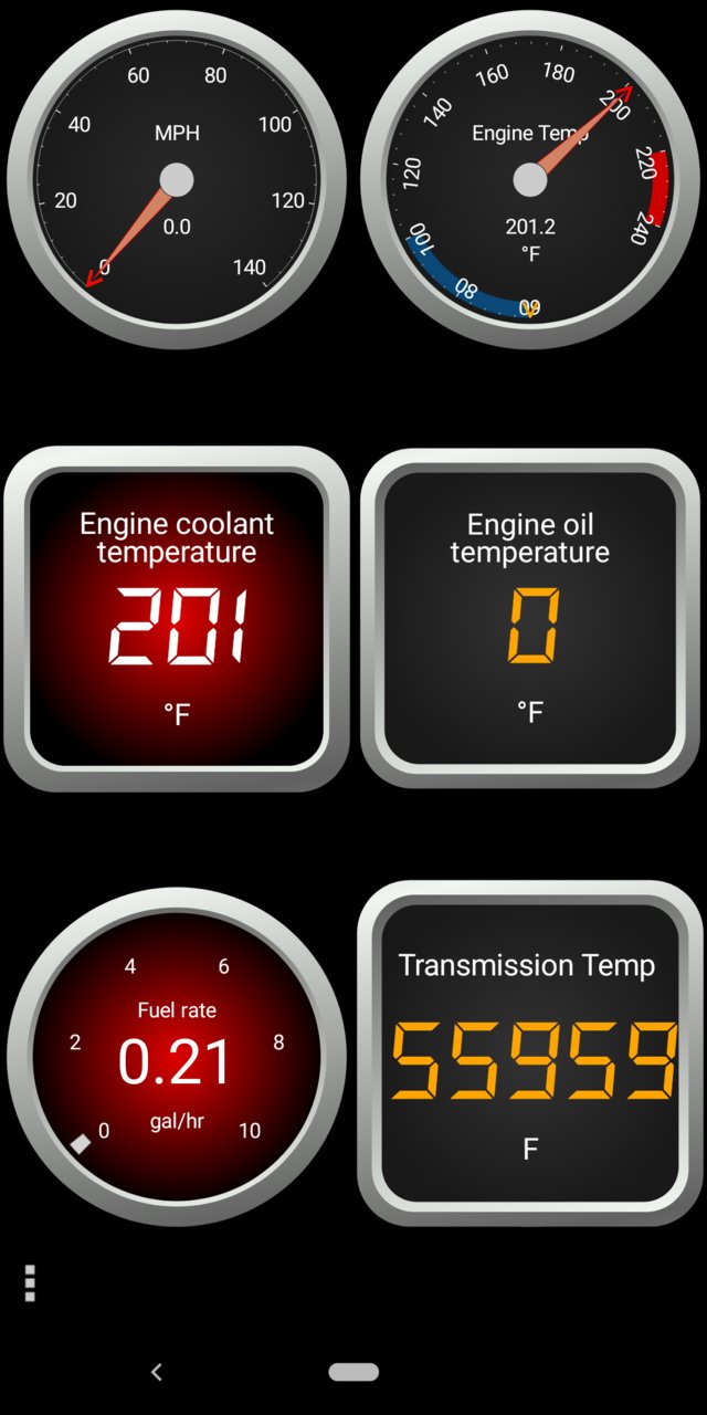

    Well, I got it to connect, but I'm pretty sure something is off.

    I use the OBD Fusion app and found I needed to buy the extra pids for Toyota and then you’ll get proper readings for trans temps and just about anything else you want, it cost an extra $ 9.99
    cryptolime likes this.
