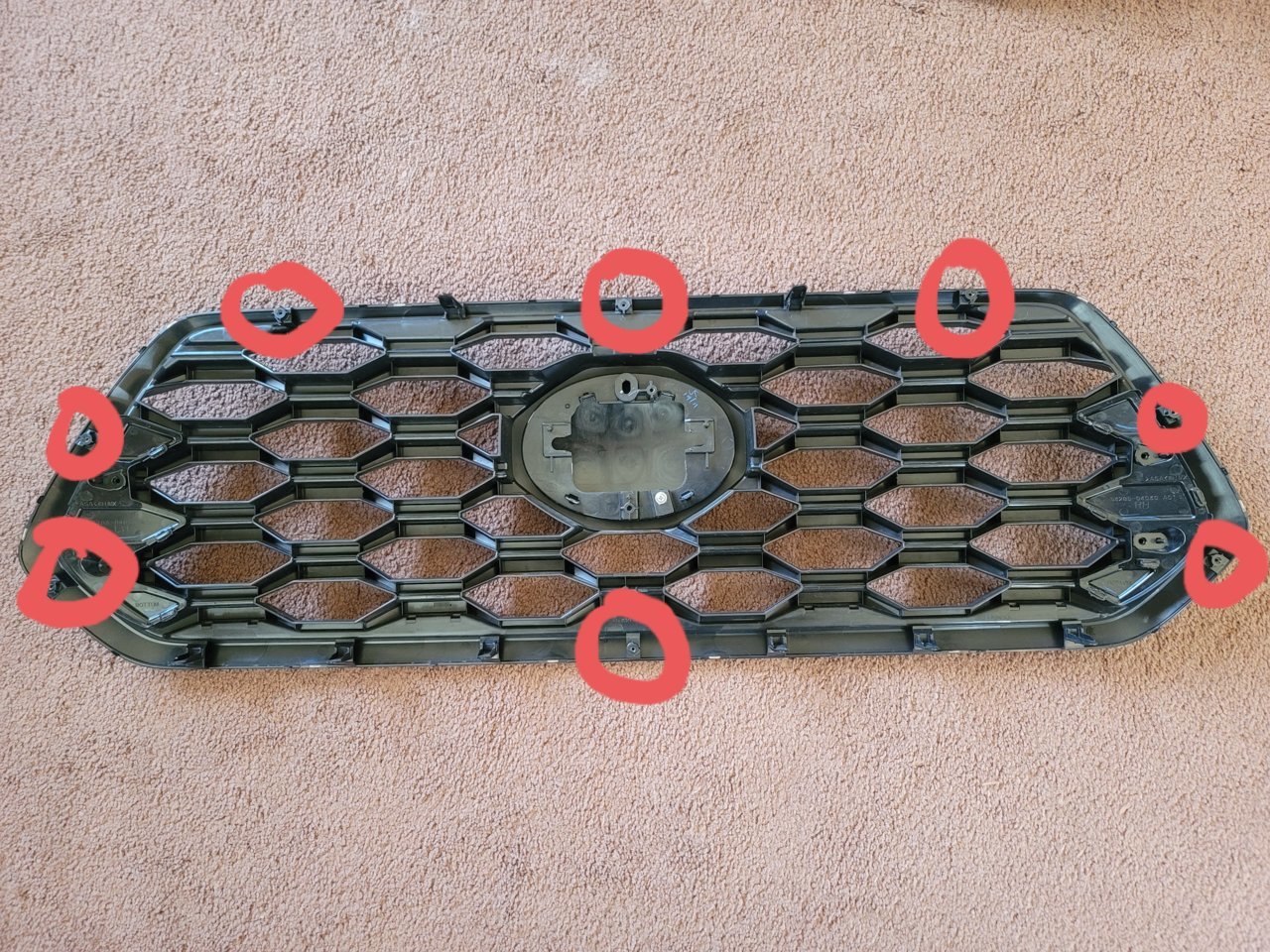

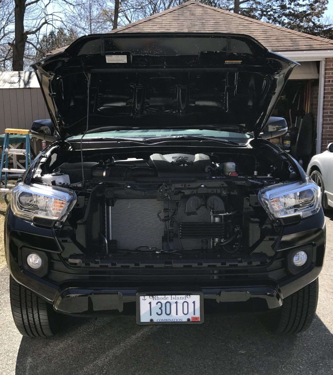

    There are 2 screws and 2 pins.
    Then it just pulls off.

    Gotta pull out towards yourself. don't pull up or down. I've removed my grille like 20 times so it falls off once I take off the bolts.
    There is only 2 bolts, 2 pins and a connector that has to be removed and all of them are easily accessible on the top. There are no bolts or pins that have to be removed on the bottom, those are for the bumper, not the grille.
    Reinstalling it is the same sequence but in reverse and you'll know if you're doing it wrong if it takes more than 1 minute to remount (trust me I felt stupid spending 2 hours mounting my grille housing back on the truck because I was installing it at an angle and not straight forward)

    My 21 OR has 3 scews in the top, two on each side, and one down in the bottom middle.
    Take the whole grill assembly off like others have said, then remove 8 screws total. 6 plastic clamps on the bottom, 2 on top and the TSS piece, then it should come right out, I believe my pro grill only had 2 screws and the clips to put back together.
    I had screws at all these points I had to remove before it would unclip.
