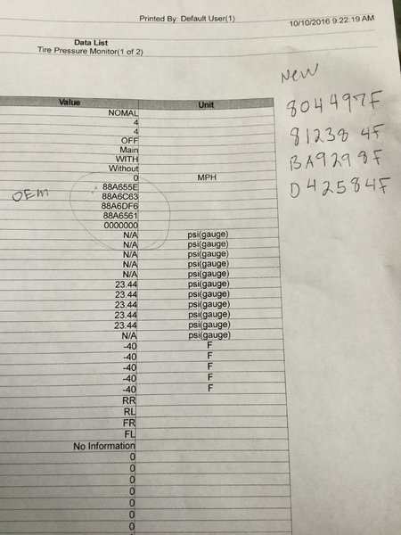

    I spent over $80 a sensor at Les Schwab Tires so I could keep the OEM rims and tires whole. As stated before, they claim to not have the device to program the 2016 Tacoma. Wish they would have told me this before they sold me the sensors and labor. Just spent 2 hours at my Toyota dealership to tell me the after market sensors are not working with my computer. FML

    Aftermarket sensors will not work with the 3rd gen Tacoma. There's 7 digits to the factory sensors and only 6 for aftermarket which the computer will not pick up even though they're the same frequency. I had the tire place I went to by factory sensors and reprogram them in. They did it for free instead of a refund

    Supposedly my aftermarket sensors are 7 digit as well. Did you have this same issue? Was this a chain tire store or a mom and pop?IMG_0066.jpg

    My aftermarket sensors were only 6 digits. It was a chain place, Tires Plus. After spending $100 at Toyota to look at it, the outcome was aftermarket sensors I had wouldn't work. Went back to the tire store and asked for a refund. Had to talk to the manager next day and he said just drop it off and they would get Toyota sensors and fix it. No charge for them doing so. Saved a big hassle
