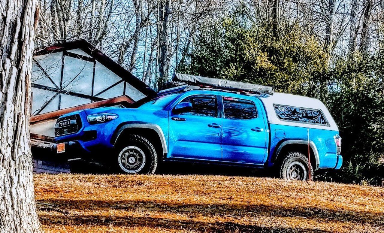

    I just bought this setup from a member on here in Massachusetts. 5 of the Bronze 16" TRD Beadlocks, and 5 S/T Maxx tires all with only 3k miles on it and 4 of them have the 2nd Gen TPMS. At first the Bronze didn't suit me and I was almost going to just swap the tires to the OEM Black Pro wheels and utilize the OEM 3rd Gen sensors, then sell the beadlocks. The Bronze is growing on me now though. If I decide to keep them all I need to do is have someone break down both sets and swap the sensors. But before I do that and pay for that I'd like to see if we can get the sensors that are in there to work. The tool is not cheap and connects directly to the OBDII port. It's pretty sophisticated. Another possible issue, when you program in the vehicle type it knows the correct PSI setting from the manuf. and if you have more or less it can throw an error while reading them. We didn't get that even though I am heavy (36psi).
    As soon as @pdenajim and I can get together again we will test all this out and I will post back with the results.
