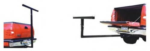

    whiskey101, If you have a rear tow hitch, here is an option, "Extend-A-Truck" for your application you would need both front and rear tow hitches and two of the extend-a-trucks. Yes, they make a front hitch. With front and rear hitches, you carry the kayak overhead, like ladder racks on your roof without touching your truck. You will see in photo what I am suggesting. Also "HarborFreight" has a less expensive version of the extend-a-truck ($55). If you have access to a welder, you can easily make your own out of 2x2 and 2-1/2 tubing.
    With one extend-a- truck you could carry your kayak half in the bed of your truck, half on the support arms.
