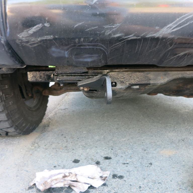

    Replaced factory front recovery point with Gladfab upgrade that will take a 3/4 inch shackle:

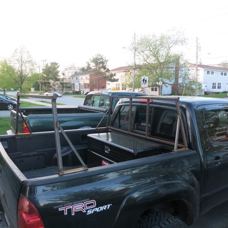

    DeeZee truck chest, and begun work on custom headache rack and canoe rack.

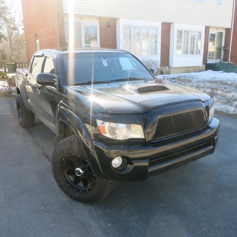

    A big step forward, the canoe rack is ready to be painted!

    You should post up a couple pictures of how it looks now! It looks great with the factory alloys and the painted rack
