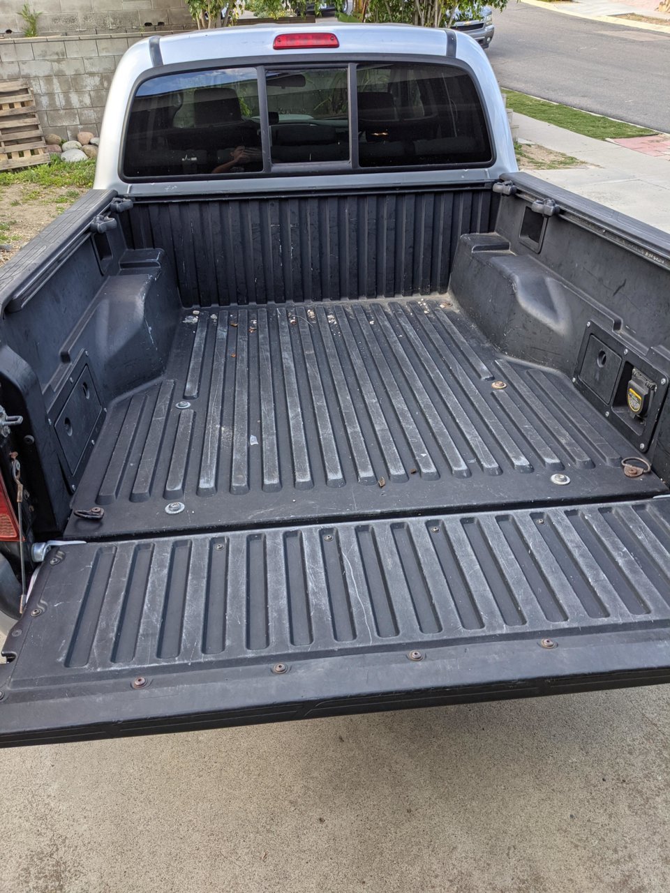

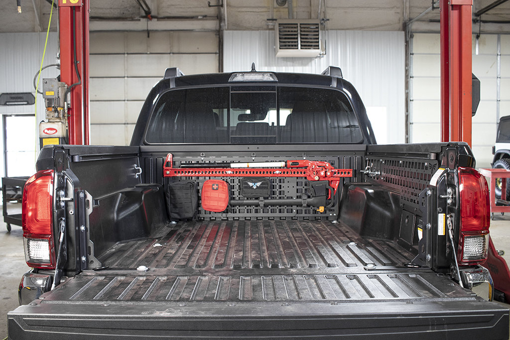

    Aside from the location at the front of the bed that people have already mentioned, the bulk of water intrusion comes from the gaps around the tailgate. If you close the tailgate, you can see right through the gaps when looking down in the bed. You'll need to address these gaps... completely doable.
    They changed this in the 3rd gen. The front bulkhead is now level with the bed sides.
