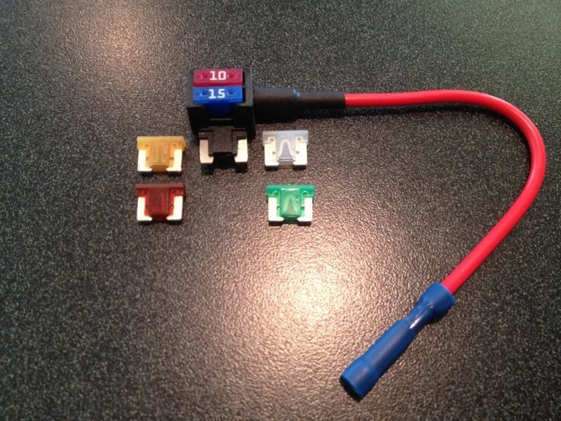

    for the power, I used a fuse tap
    in an empty fuse spot that had unswitched power, I think it was the empty fuse labeld '7' on the diagrams, but I'd have to go look.
    if I'd done it right, I would have run the wire from a empty fuse slot in the junction box in the cab (under dash on left side), under the driver door sill, and down to the frame under the back seat where the main harnesses are routed. but, I was able to run it under the left fender, and onto the frame such that it is clear of all suspension components, and is secured with G-B black tiewraps, which I've found last a long time.
