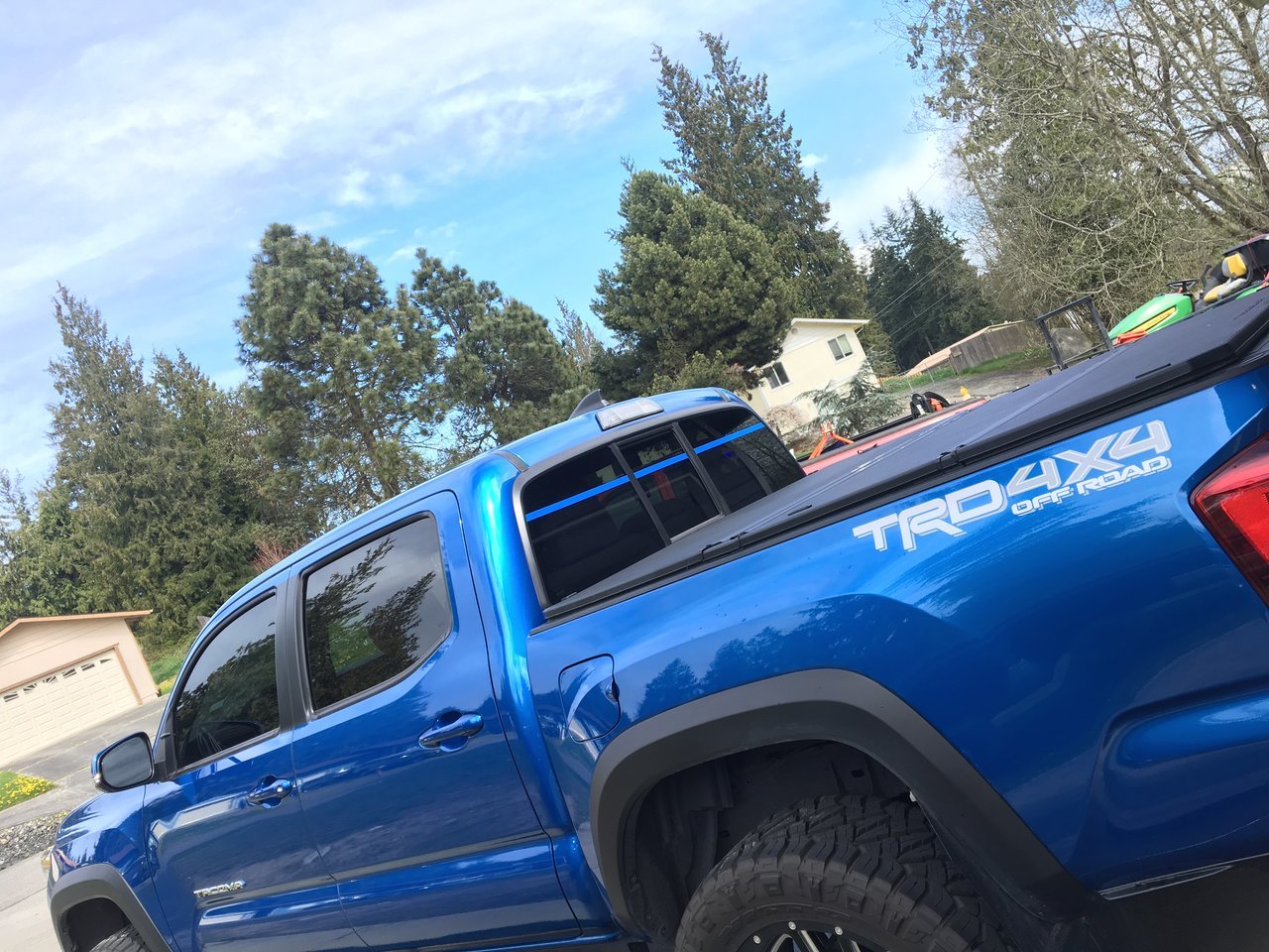

    I have a 2016 TRD OR Short bed (Double cab), that had the tonneau cover on it. I just happened to find a color matched SnugTop on craigslist and snagged it at the time. The guy had traded his truck in that was identical to mine, and kept the canopy to resell.
    He helped me put it on, and we had to remove those latch pieces off the side rails, and the brace off the middle of the back rail (by the cab) in order for the canopy to fit snug on the rails. Once those are out of the way, it fits perfect. It's only 2 bolts per latch point.
    Before:
    After:
