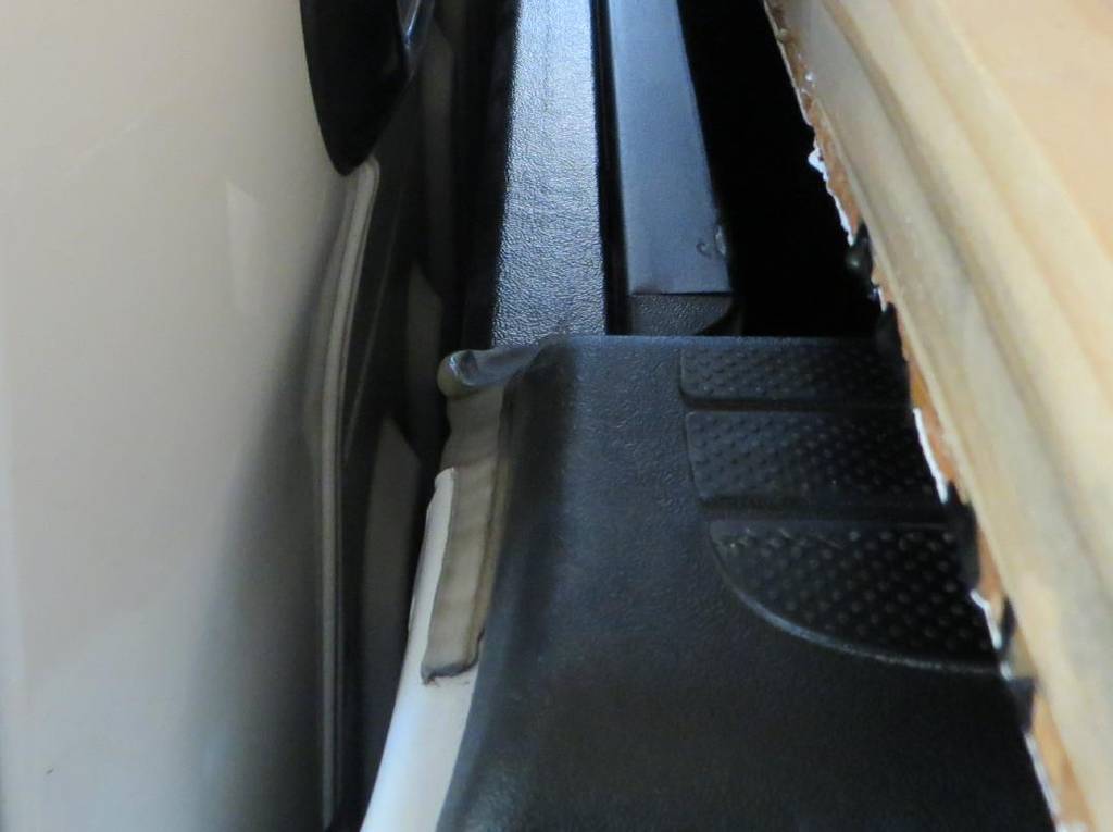

    Here's a photo of the silicon my leer dealer put at the front corner of the bed liner and along the front bed rail . You can see they put more on than just the corners, extend it along the front of the bed rail.

    No tape on the front of the bed ?

    The Leer has a permanent rubber gasket all the way around that seals the front. Only needs the sealant at the front corners. I've taken the shell off and on multiple times and never had a problem with leaks and never had to replace the sealant.
