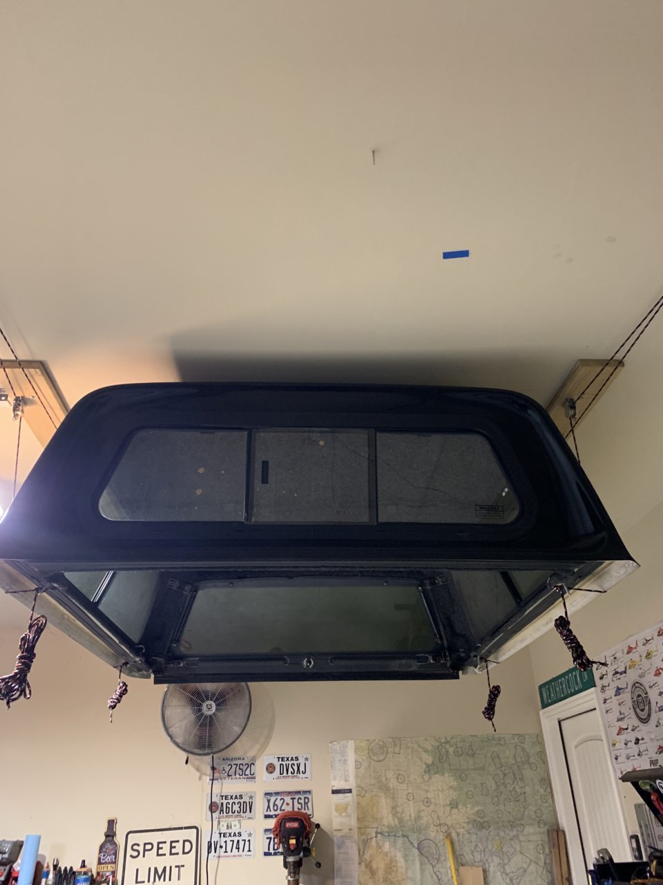

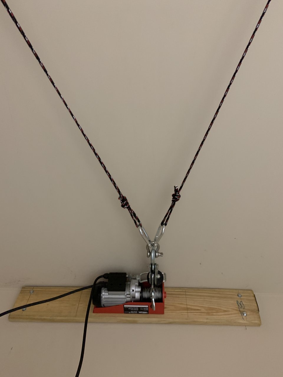

    A hoist from northern tools and some simple rigging should do the trick. I use this for my topper.
    9DB4A83F-D6E8-4B4D-A06B-575CCC9032BA.jpg 6252255C-E94D-4851-B4C6-00BAB47826CA.jpg
    Made a few revisions since those pics. All said and done it was under $100.
    It's not exactly the same thing but you could just hook up to the four corners, don't see why it wouldn't work.

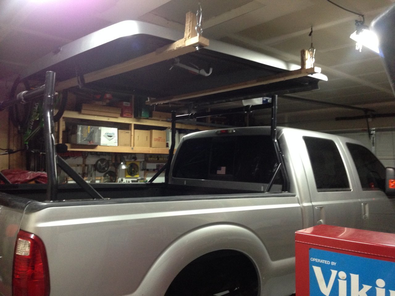

    Dirt, barkdust, etc, fits in a canopy great. It's things like couches, beds, and dressers that cause problems. Tailgate to top of the door is 34" on mine so anything taller than that is a headache;
    Our fiberglass cap weighs close to 100lbs, it's not heavy just awkward. When we've taken it off it sits on sawhorses in the garage. If I was going to build a canopy lift I would do something like this and build crossbars or a platform to lift it from;

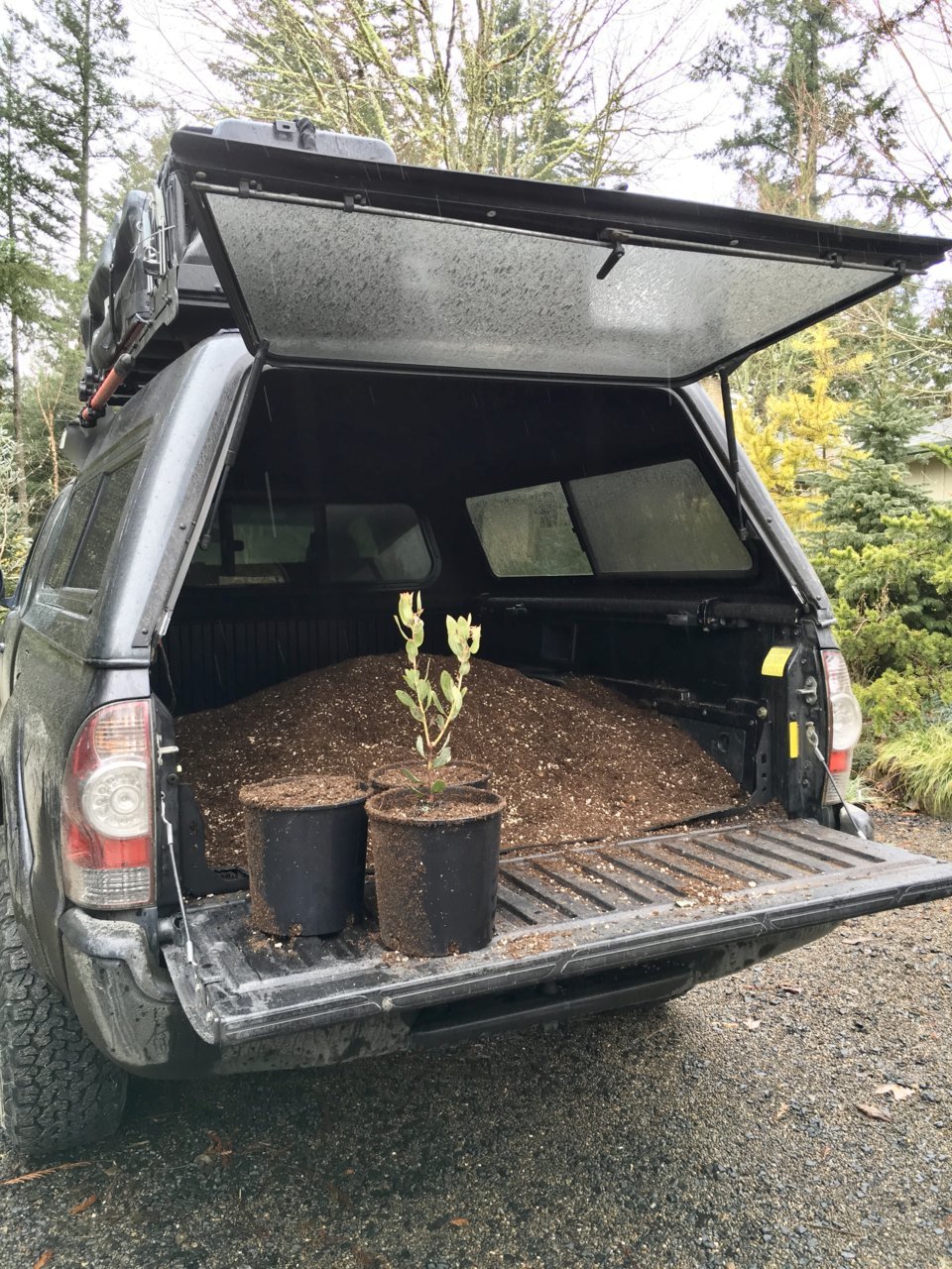

    I picked up a yard of soil just yesterday. I grow plants for a living and use tons of potting soil, so I’ve got the routine down. Usually if the driver isn’t busy they’ll park the front loader level with the tailgate so you can shovel it in yourself. If it’s busy bring a tarp and they’ll dump it at your tailgate. Either way you’re gonna get a workout. it may not be an ideal solution, but It’s definitely doable.
