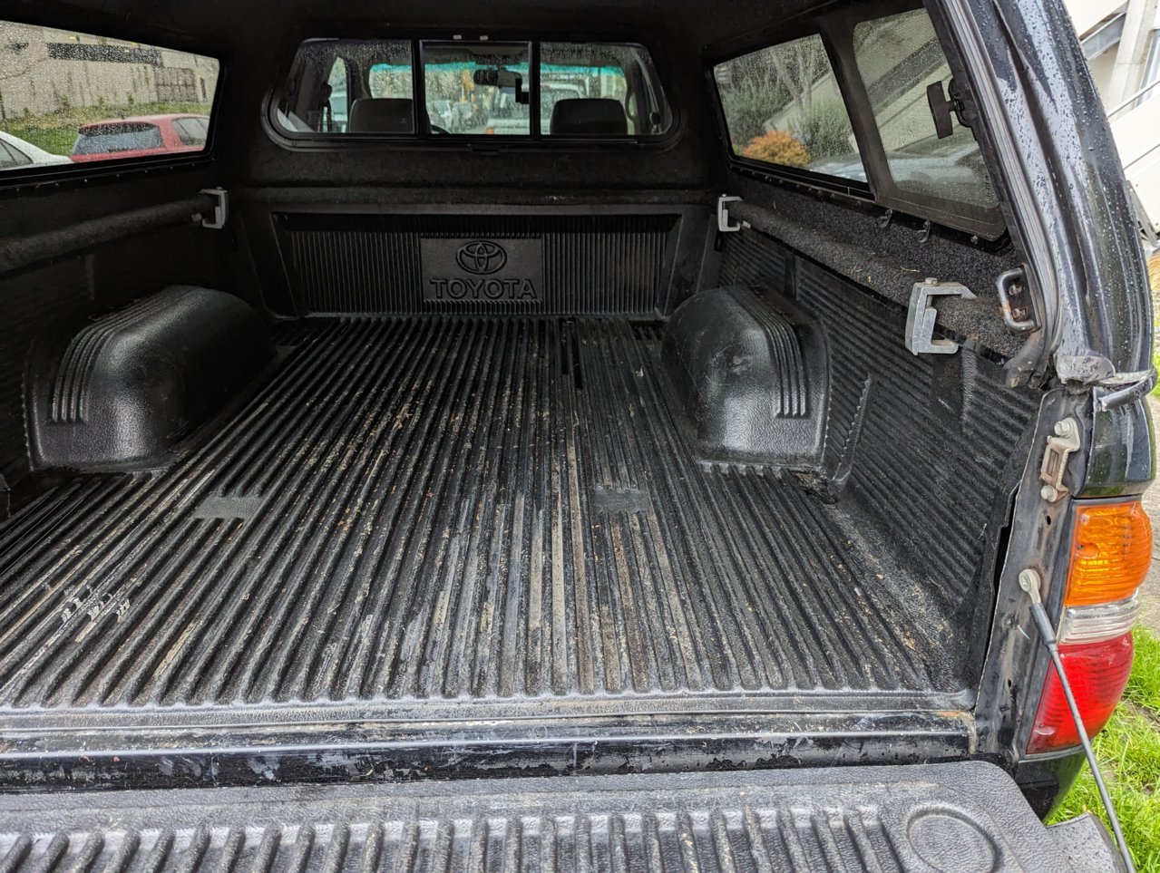

    My current truck ('02) has an over-the-rail plastic insert. The new truck ('04) has an under the rail plastic insert and a Leer canopy. I've not had a canopy in the past and am not familiar with the best way to fit them.
    Does the Leer seat better to the bedrails with a gasket? Or would it be worth swapping the liners, so the canopy was sitting on top of the over-the-rail liner, with a gasket?

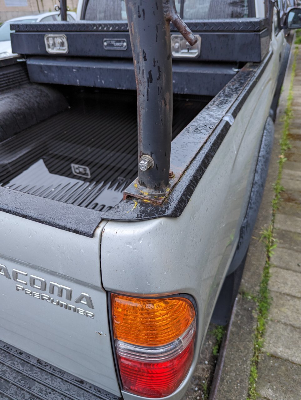

    Silver truck has the insert which could be swapped into black truck. But it would be a pita.

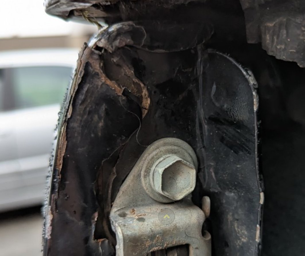

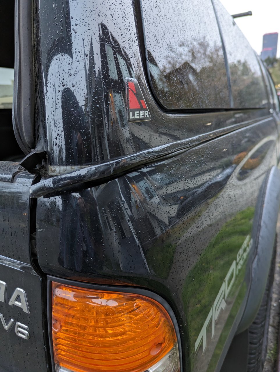

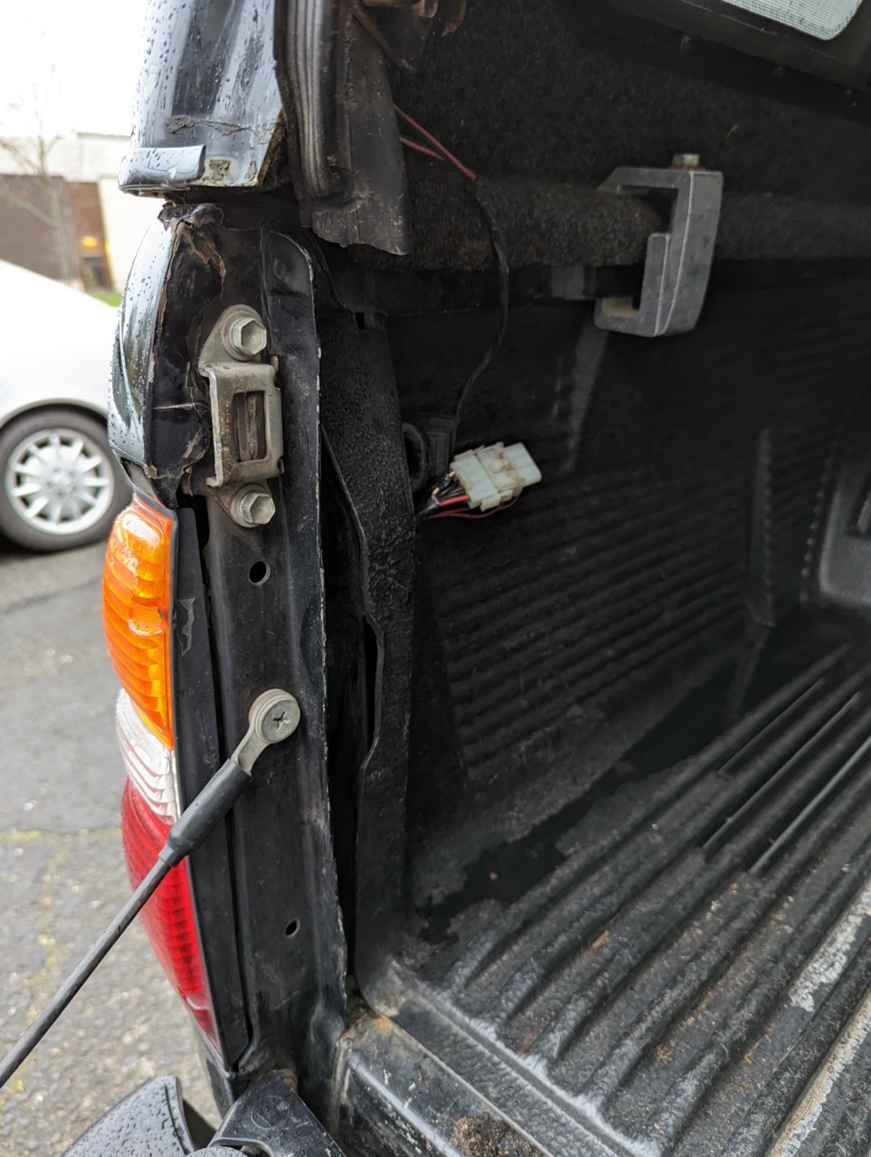

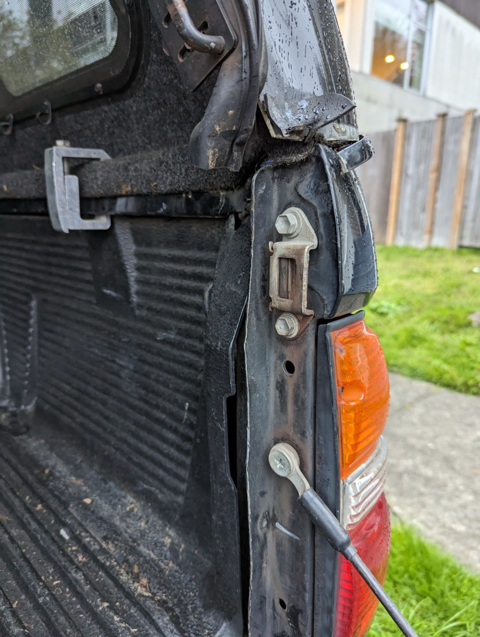

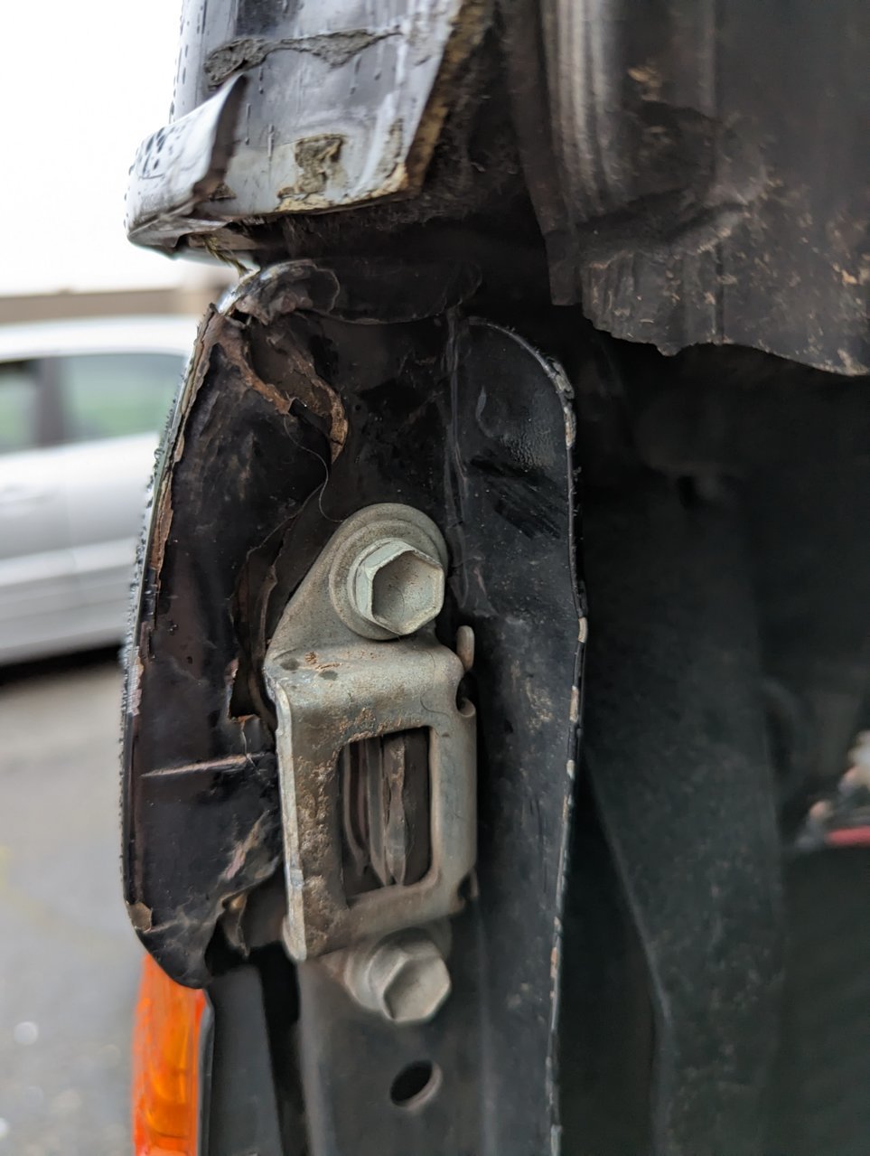

    Black truck has an interesting failure at the weld for the left rear panel, just above the tail light. Can't see any large impact signs, which has me guessing it's a fatigue failure from the canopy. There's a dent in that panel, but seems like it wouldn't be enough to cause a failure at the tail light.
    Is this a common failure point?
    This is what got me thinking of making the insert swap.
    But after thinking about it over the weekend, I think I'm going to leave the liners where they are. There are a couple other body items that need some love. Planning to take off the cap and remove the insert to see what's going on, and get an estimate from a body shop close to us. Not trying to restore it, just want to fix the damage and mend some paint issues on the roof.
