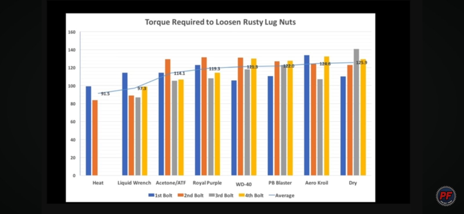

    This is the first video of his I've watched in at least a year because he used to only use a sample size of 1. I'm so glad he started using a sample size greater than 1. Also, that ATF/Acetone looks delicious!
    Bertw192[QUOTED] likes this.

    Sometimes his style of repeating the product names over and over gets annoying, but I appreciate his practical attempts to review many tools and products.
