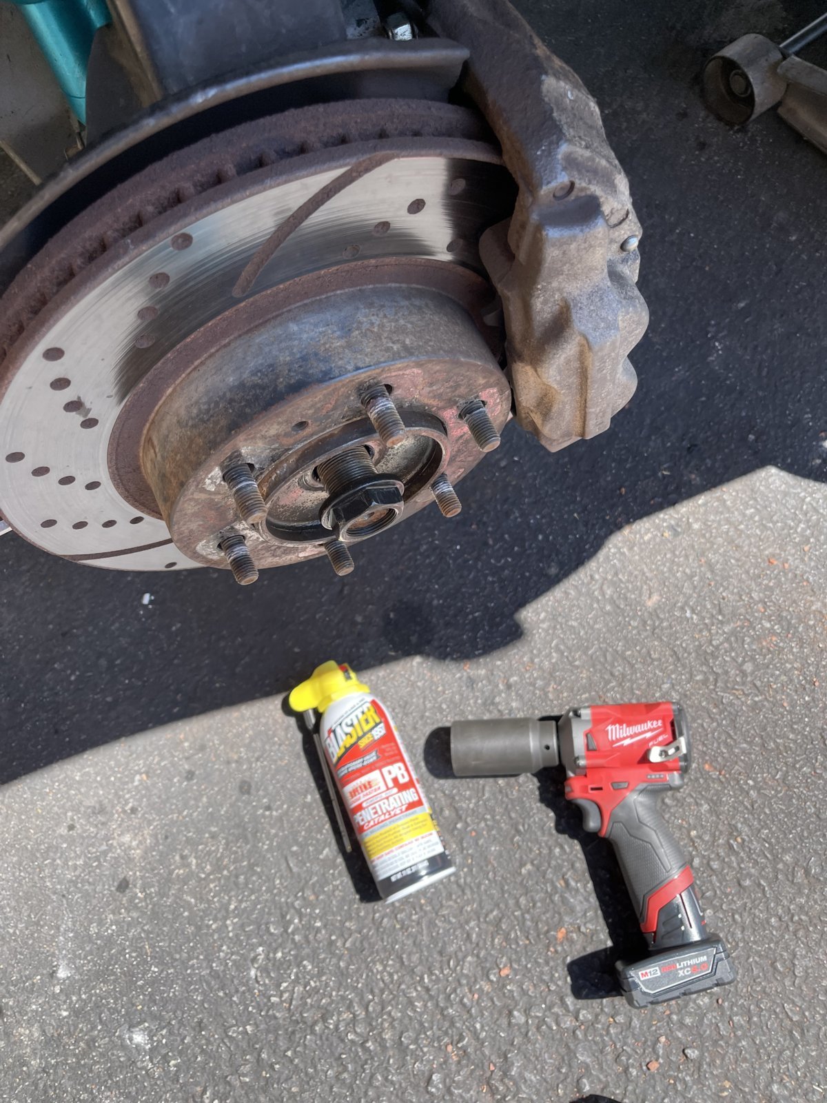

    Thats crazy that you bent your breaker bar. I don't think Ive ever seen that. I had a hard time with my Milwaukee M12 1/2" impact and PB blaster, but I got it done. Max breakaway torque is 250 on paper..

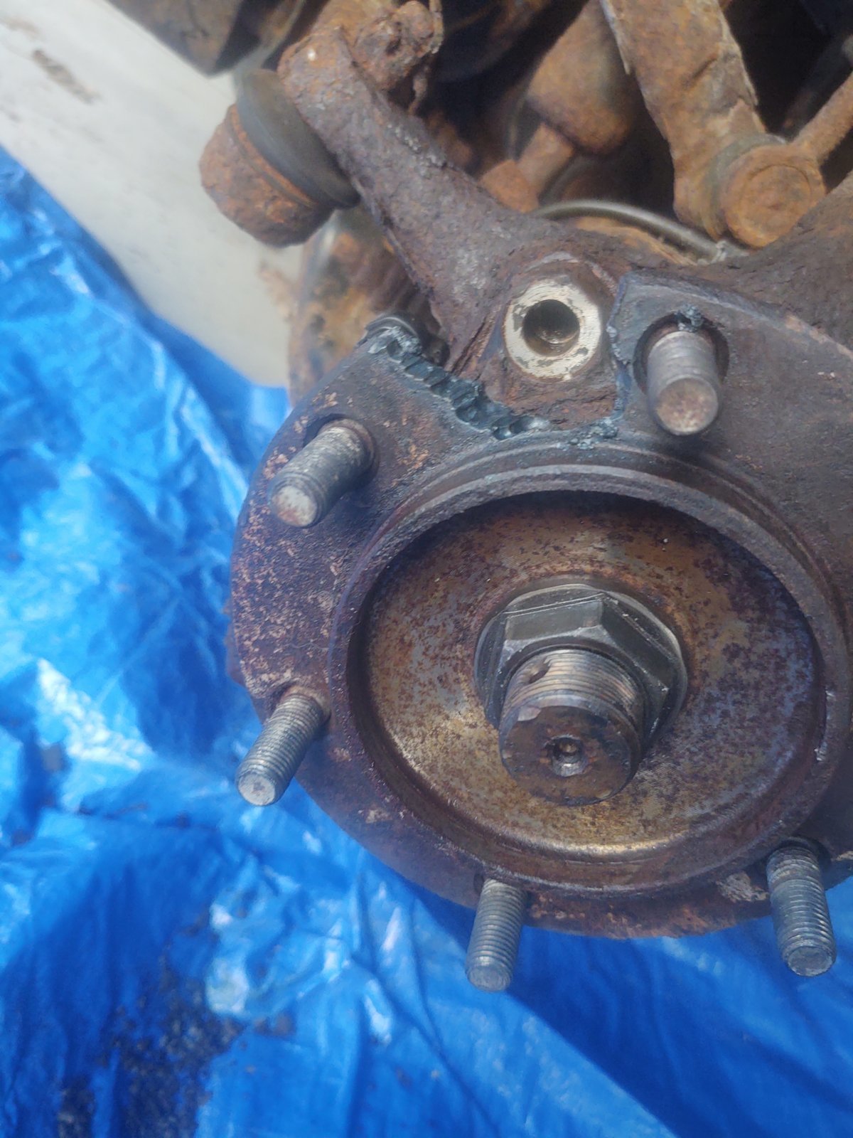

    The four Mounting bolts were so rusty, that by the time i chipped all the rust off the heads they were rounded. The open end
    Of the 17mm was just slipping. The box end of the wrench was 12 point and it was just adding to the rounding. I had to cut an opening with the torch in the hub to get a six sided socket on them

    this truck isn't going anywhere now.

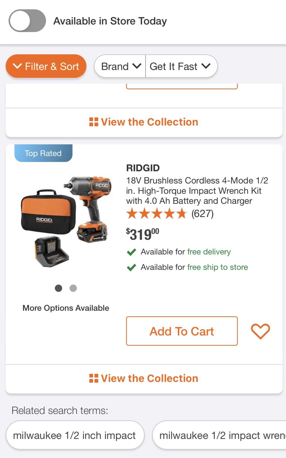

    I use Kroil and impact. This one seems to be the Armageddon of rusted axle nuts.
    HD isn't offering any deals right now, but this is the one that's in my tool chest.
