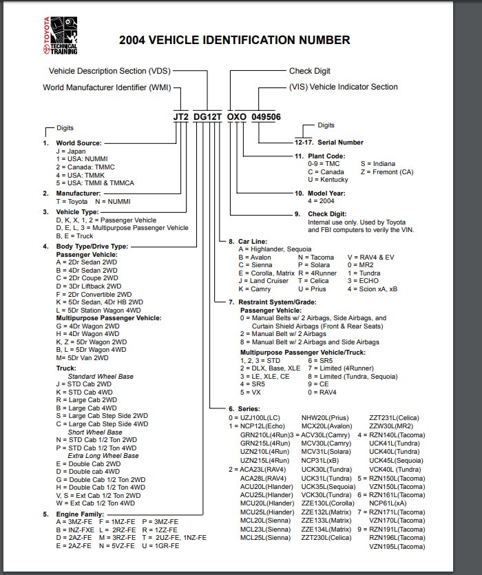

    5 USA
    T Toyota
    E Multipurpose passenger vehicle
    H 4dr Wagon 4WD
    N 5VZ-FE
    7 ?
    2 Manual Belts w/2 airbags
    N Tacoma
    9 ?
    4 2004
    Z Fremont CA

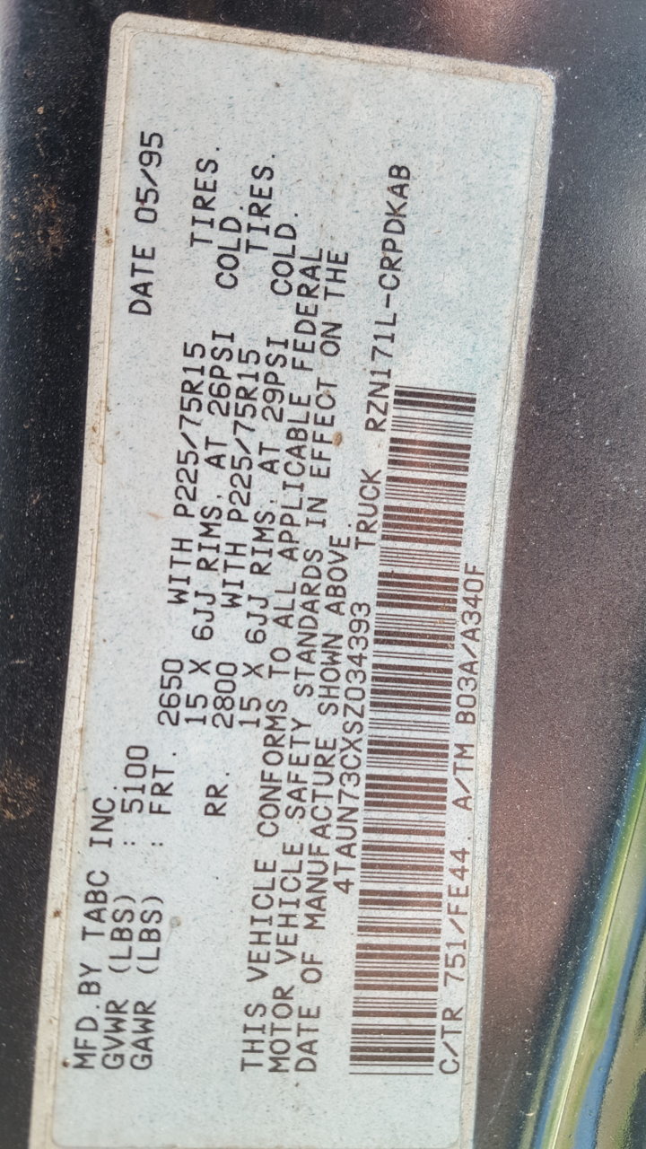

    I've got two 1995, one May and one June. Both look same as Jamesboy's VIN as far as Plant Code = Z, Freemont (NUMMI).

    Vehicles built in the later parts of year X have been sold as model year X+1 since forever. It's still 2018, and you can can already buy a model year 2019 vehicle from Toyota and most other manufacturers.
