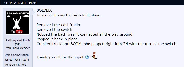

    There are multiple issues that cause that and one is the harness/plug on the 4wd switch coming loose .

    I'll have to look at that while I'm down there. Unfortunately the switch being loose wasn't my issue.
