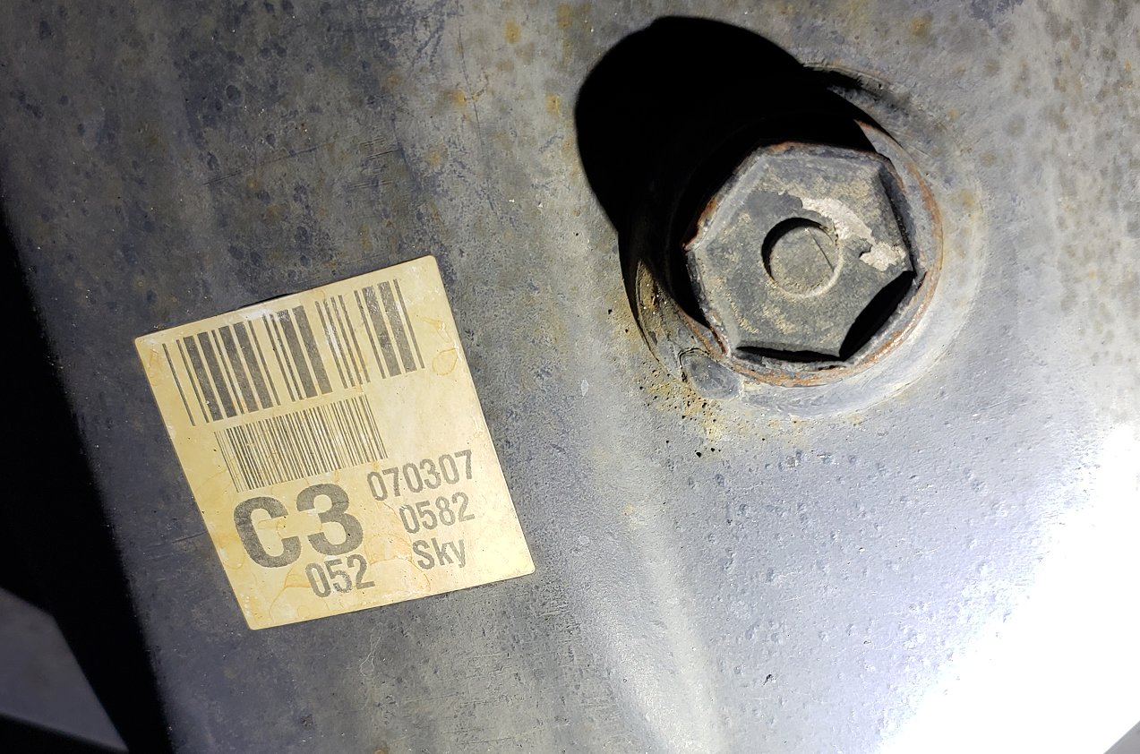

    It's a 2007 Tacoma V6 4.0l prerunner 2wd. the door sticker is a04a/a750e. The diff only has one sticker on it, C3 052 07307 0582 SKY. there is no limited slip sticker, but it's an old truck and may have come off. Driving in the sand is sure doesn't feel like it has limited slip but that may be because I didn't use an lsd additive in the oil.
    Thank you. Also I've been reading through old posts for an hour, everyone seems to be contradicting each other, crazy it's so hard to figure out.

    oooh i see. Thanks. so just use regular 75w90 gear oil.

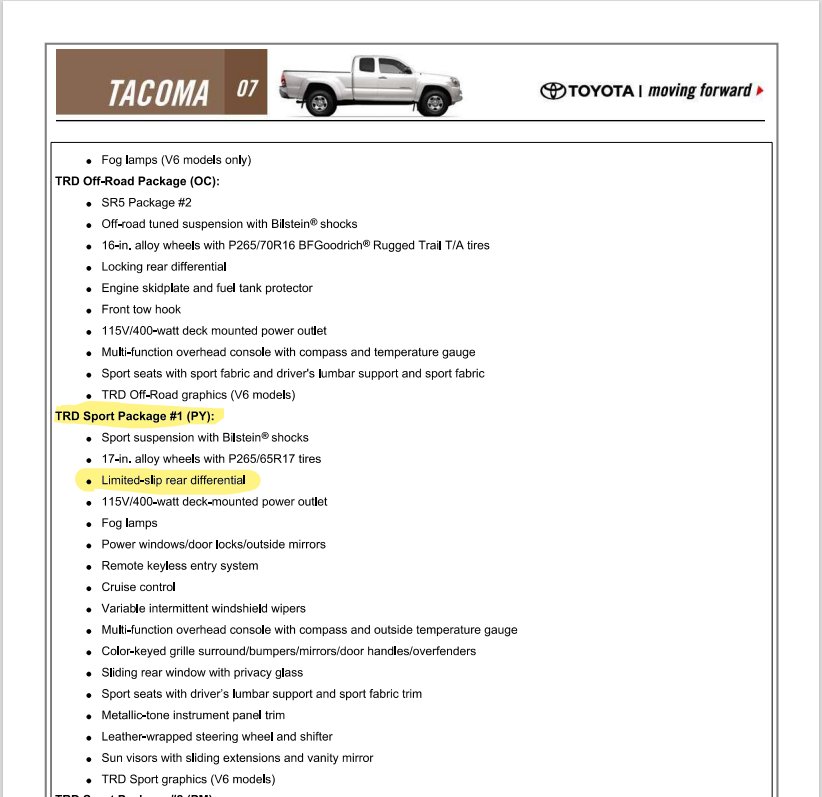

    The 2007 Tacoma Sport came with a LSD. If your truck is a 2007 and is a sport model it has a LSD.

    Just an update to my earlier post regarding LSD.
    For 2005-2008 you could only get a LSD in the TRD Sport Tacoma's. From 2009-2015 every Tacoma came standard with an Automatic Limited-Slip Differential (Auto LSD).

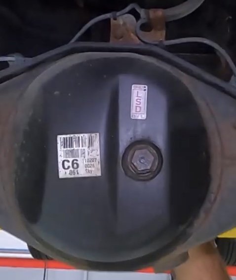

    Hey look the LSD sticker.
    If your truck is old you MAY see the outline of this as it may be sprayed over by “insert product here”.

    oh awesome! thank you! definetly nothing there so i'm 99% sure no lsd. thank you guys for the help!
