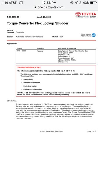

    There is a TSB for a torque converter lock up shudder from 3rd to 4th that causes a "rumble strip" feeling while driving. All that is done is a Econ reflash to prevent incorrect learning values. Only thing is it's for a 4banger.

    There is also a newly designed torque converter for the V6. Due to a shudder issue and something else. It is also more robust than the previous version.
