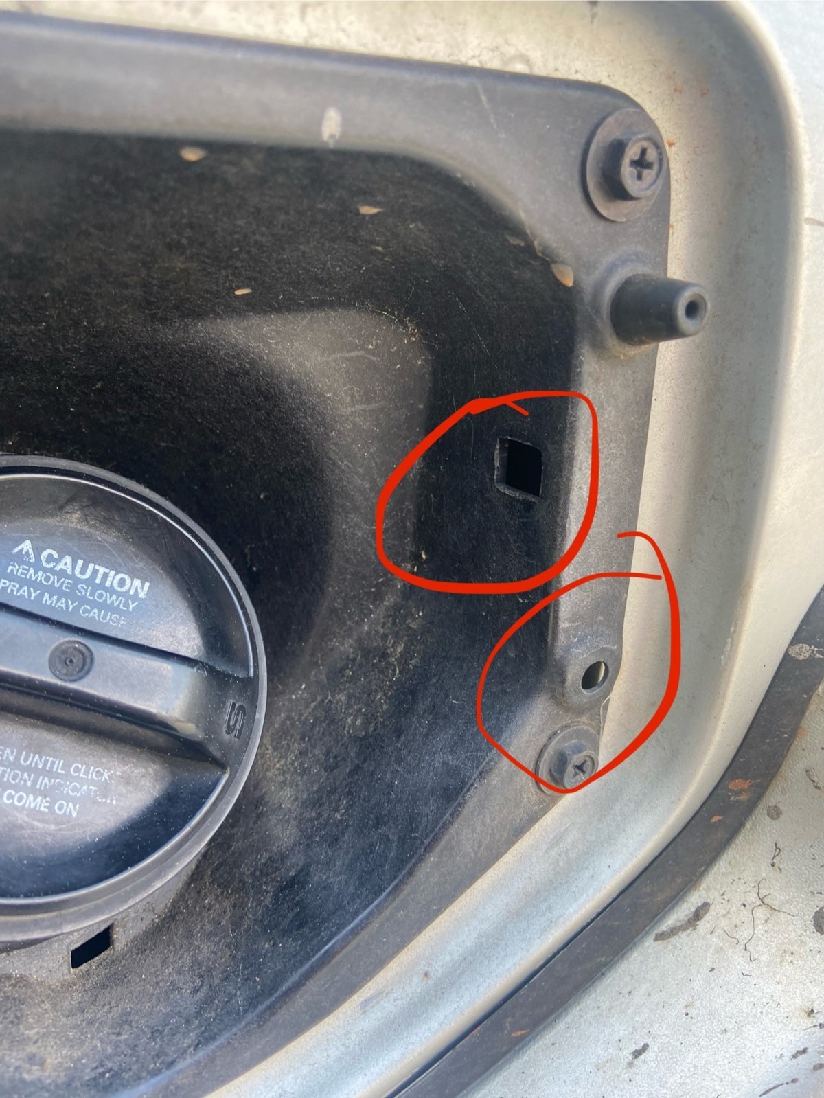

    Not even the dealer knew what the part numbers were. I need the LATCH and one of the BUMP STOPS for the fuel door. What are the part #s?

    Stopper is the latch.

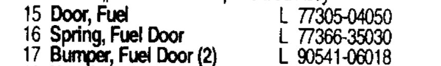

    I believe the rubber bumpers are p/n 90541-06018. But on my 2003, there are two different kinds of bumpers, a tall one up top and a short one in the lower postion. I got one years ago for my previous 2001 Gen 1, and ISTR the p/n is for the two of the tall kind like the single one you have, @Krugermeier.

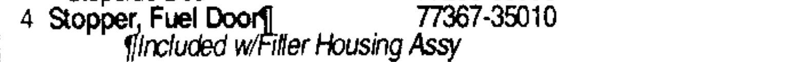

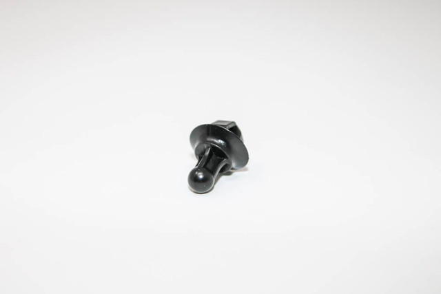

    The latch pin for my 2003 is, I believe, p/n 77367-35010. Be sure to double check these against whatever year is your Tacoma (and remember to mention that in future posts so we have a better starting point).
    Here's one of a thousand Google images of it.
