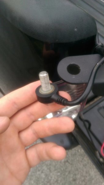

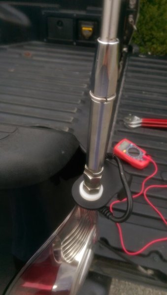

    So I got my multimeter today but wasn't sure how to check the both the ground and center conductor of the cable I have (picture attached). I can't figure out with this type of cable whether I should be sanding off some of the powder coat underneath the mount or not. I've tested the center conductor, however, and it did not have issues.

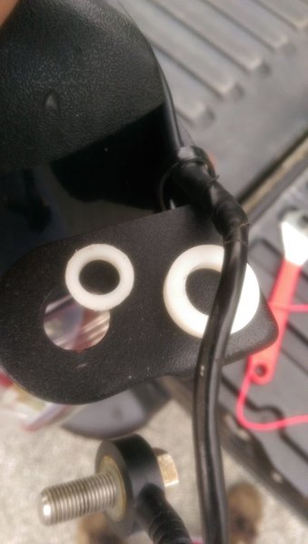

    I also uploaded pics of the plastic washer I made from hardware store synthetic washers, but I don't think that's the issue.
    I believe my issue is grounding the mount. Where would you guys recommend running ground straps if I determine that's the problem?

    The bottom of the mount bracket needs to be bare of powder coat in order to ground with the firering cable.
    For what its worth, the firering cable ends suck. They corrode and your ground goes to shit. Mine was toast in under a year. I switched to a wilson 1000 mag mount on the roof and have WAY better range.

    Final Update: Everything looks amazing. SWR of 1-1.3. I scraped off the powder coating on the bottom of the mount and a little more around the mounting screws just to be sure. Used a multimeter to confirm solid ground from the inside-the-cab end of the coax all the way to the negative terminal on the battery and everything had continuity. That gave me an SWR of about 1.5-2.5. Started tuning the antenna (had to shorten about 2") and everything fell into place. Thank you guys for your help, I'd buy each of you a beer if I could ;)
