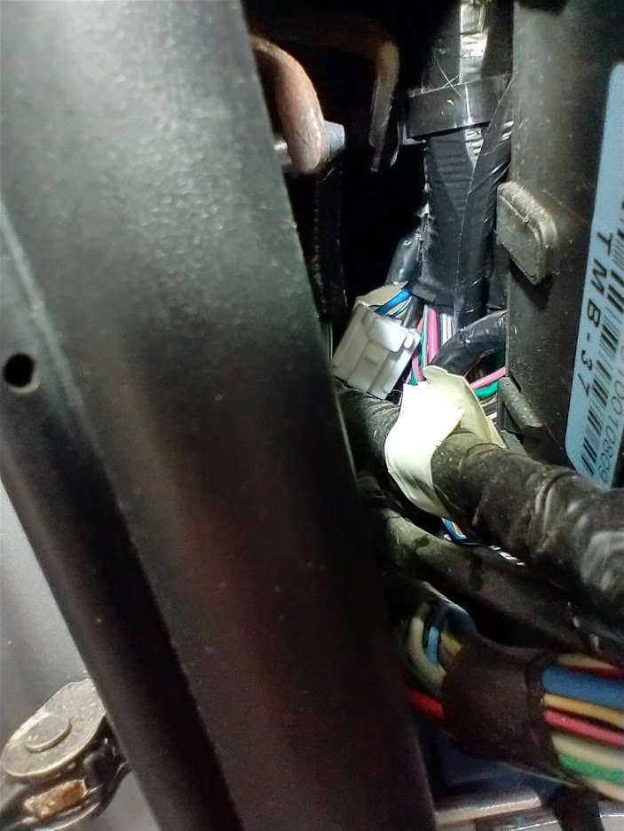

    Okay, so I found the white connector under the dash.
    My next question is, where do the wires go? Does it follow one of these bundles?

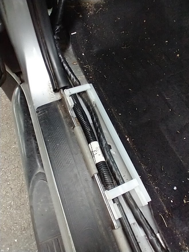

    Anybody? I am still looking for the black and blue wire in the back of the truck.
