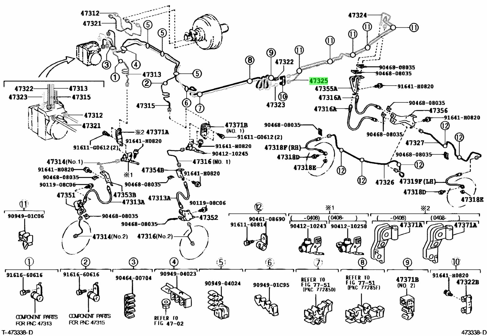

    I've looked at many brake line diagrams, which list the part I need as 47315, but when I search for the part, it shows something different.
    I need the hard line that starts at the driver's side brake, coils up, then snakes across the back of the engine and into the actuator assembly on the passenger's side.
    Any idea where I can get this part?

    Could it be Toyota part number 47315-04170?

    Picked up the above part number which the Toyota diagrams have the entire run from actuator to wheel listed as the part. The part I received was about 18” long and requires cutting and flaring into the existing line. Even the Toyota parts guy was confused. Is the only way to get the hard lines a single run is to make them your own? Doesn’t seem right (Not like toyota dealers bend their own…).

    you’d be better off getting copper nickel brake line and making it yourself. Very easy to work with and will not rust out
