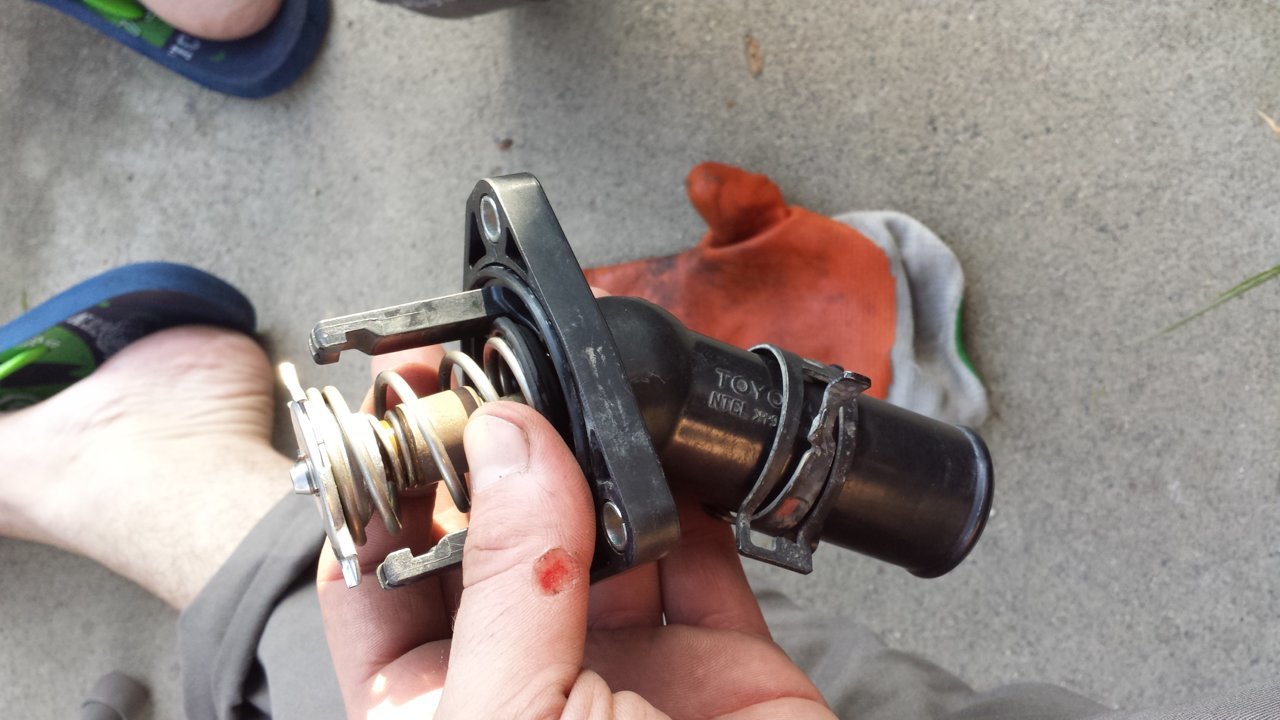

    Anyone know ow a trick on how to get the thermostat back In the housing??

    Holy hell it's a tight little spring
