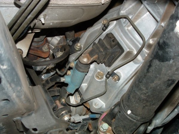

    I started replacing my clutch slave cylinder and master cylinder today and my hard line directly out of my slave cylinder has a bushing that will not spin so I cannot reuse the hard line. I have been searching for about 20minutes for where to buy another line but cant find it. Can anyone help me locate one? Thanks in advance!! here is a picture of the line I am needing

    By not spin, do you mean won't turn, as in stuck?
    If so, you need to buy a "flare nut" wrench. It is a six sided box wrench with a slot to let the line pass through it. Will prolly fit your fuel filter as well.
    I'd guess 14mm. Should come off, unless you have bunged it up bad.

    I have used a 12mm flare nut wrench the whole time and it will not sping free on the line as in, the thread head and hard line are stuck together. I had a new braided line made though so we are back in action

    Wow, that was some serious corrosion!
    And that looked like the cleanest bell housing ever on a used vehicle.
