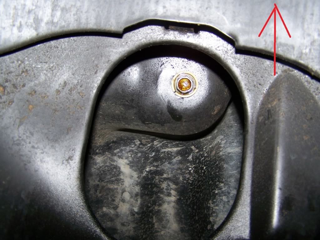

    the oil plug is a foot in front of the tranny plug... many ppl have done the same. there is a hole in the skidplate

    there is a peek through near the steering rack that you can see the oil pan and the drain plug, if you need a pic let me know

    ya, a pic would be great

    ask and ye shall recieve, pay no attention to my cracked washer
    the arrow notes which way is forward

    Ok, thanks . doesn't look like any drain plug I've seen before. like I said , I haven't change my own oil in a long time. I'll look for it tomarrow.
