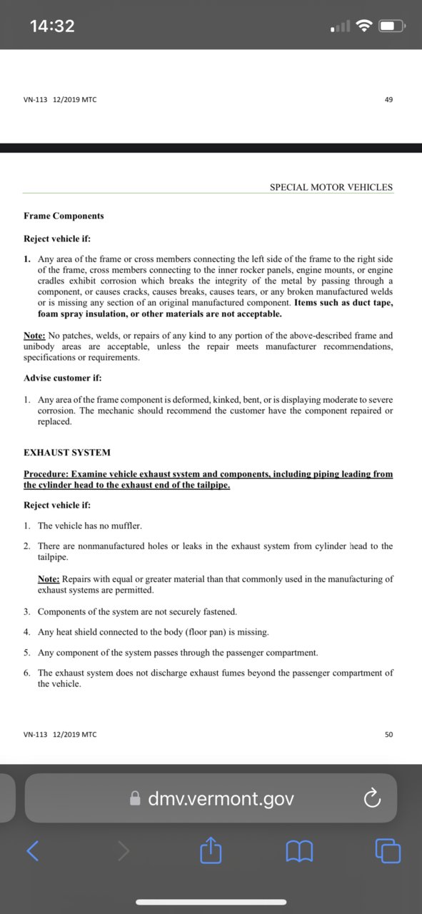

    I bought a 2004 Tacoma from Ebay. I totally got screwed. The truck was one of those that should have had the frame replaced but the person who owned it opted to weld it instead. In my state of Vermont, you can't get an inspection sticker on your vehicle if the frame has been welded on.

    Can anyone give me some advice on what to do from here?

    Looks like you have an out if you can prove it was welded to manufacturer specs. @Empty_Lord - do you know if Toyota even has such specifications for welding frame repair?

    Got any pictures of the welded areas?

    I have been to three small garages. VT is so strict that they all worry about losing their licenses so they won’t put a sticker on it. Actually I would feel terrible asking them to do something they aren’t supposed to do and cause them to lose their business.
    I haven’t checked with Browns salvage yet.
    I have looked online and most sites say “discontinued “
    They smeared axle grease or something all over.
    Ugh!
