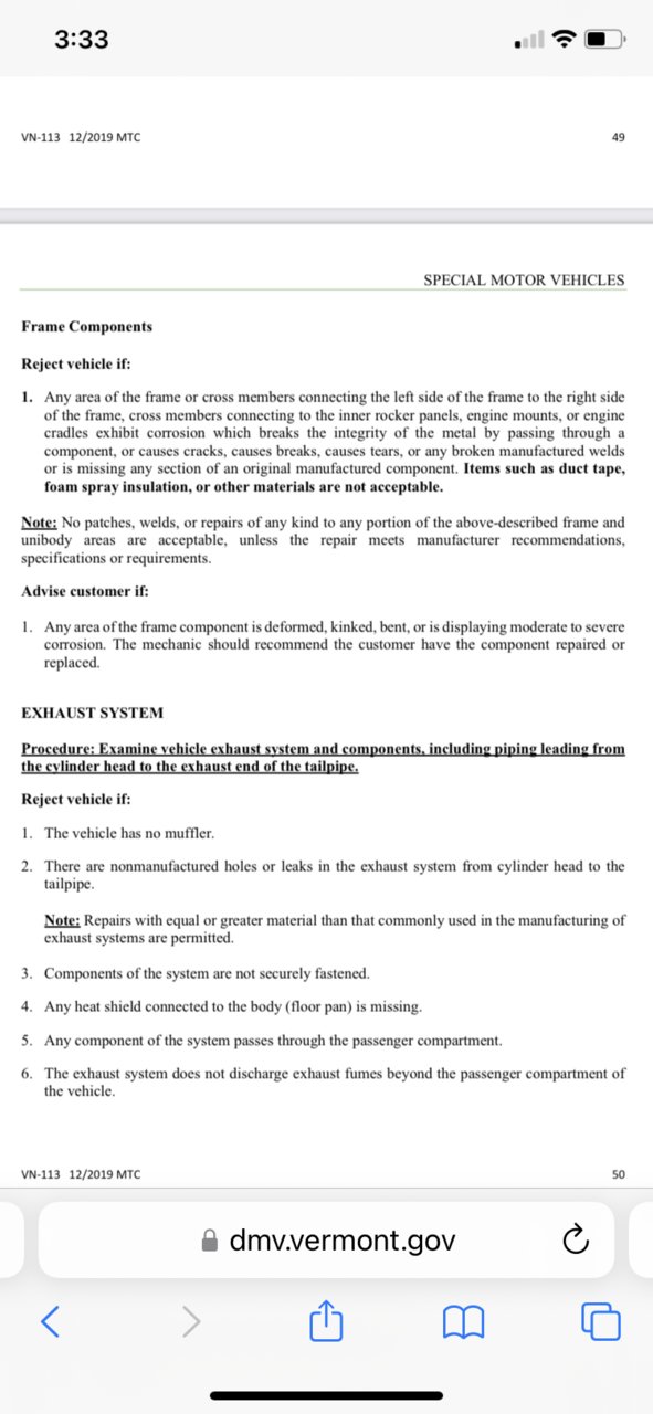

    I found the Safe-t-Cap site before posting this thread, but when three mechanics told me they wouldn’t be willing to put a sticker on it because VT doesn’t allow welding on frames, I kind of got desperate and came to you all for help.

    Does vermont have a "Referee" station you can go to to appeal an inspection sticker failure ( they do here in Mass).
    It may be worth looking into this and setting up a meeting with them in person (and bring along printed info from the safety cap website). I'd also bring along any info you have to prove that Toyota stopped making the frame for your truck.
    Ask them what they would due in your situation. New frames aren't available, welding isn't allowed, and a junkyard frame won't have the correct VIN # for your truck, which is a story for another day.
    I'm curious as to what course of action they would recomend.

    You seem to be more focused on getting it to pass inspection, instead of considering an unsafe vehicle on the road. I understand that you spent your money, but these vehicles are considered unsafe, thus the major recall. Sell it for parts and consider it a teaching moment. When I have customers asking for advice on purchasing a used vehicle from a private owner, I always suggest they give a partial payment, with the remaining to be paid once an inspection is conducted and passed. Minor issues can be negotiated, but major issues are grounds for cancelling the sale. Hope you and the previous owner can come to an agreement.

    The O.P. bought this truck over a year ago. The truck already passed inspection in Vermont 1 time since the O.P. purchased it.
    I think it's a little late to work out an agreement with the former owner.
    I'm certainly not defending the seller, but the fact of the matter is that truck would pass inspections in a lot of states.

    Op paid 1000$ to pass first time should have fought it then.
    inspection is less than 100$.
    Sorry op is a fellow Vermonter but this should have been a fight a yr ago and not now.
    Before putting money into fixing that spot truck needs to gone thru.
    Seems to have a lot of shade tree shit going on.
    Not sure if that round stock welded to frame is supposed to be sliders?
    A through inspection is needed before going further I believe.
