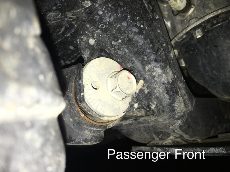

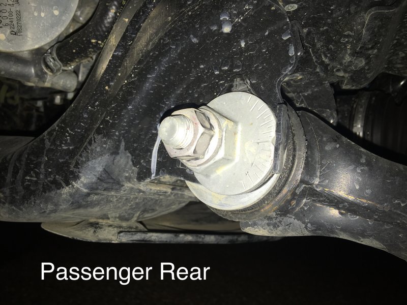

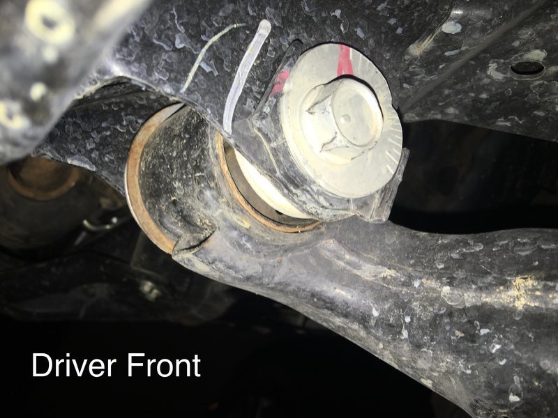

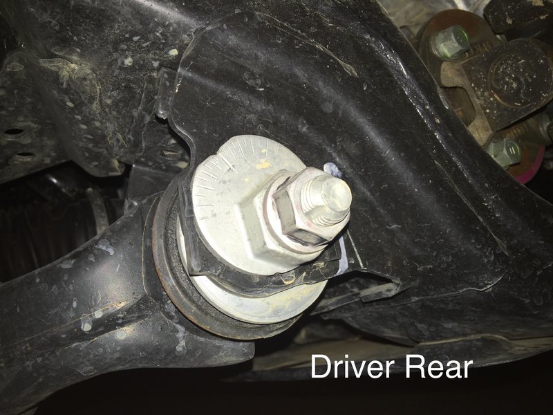

    Front Driver Side Eccentric
    Rear Driver Side Eccentric
    Front Passenger Side Eccentric
    Rear Passenger Side Eccentric

    Get a new alignment tech. You can clearly move the front eccentric "longer" which will both reduce your camber (get it closer to 0 or slightly negative with IFS) as well as reduce your caster.

    Moving the front eccentric longer will decrease camber and decrease caster without touching the back eccentrics. Given the rear eccentrics are roughly in the middle, you've got a lot of wiggle room to get more favorable numbers.

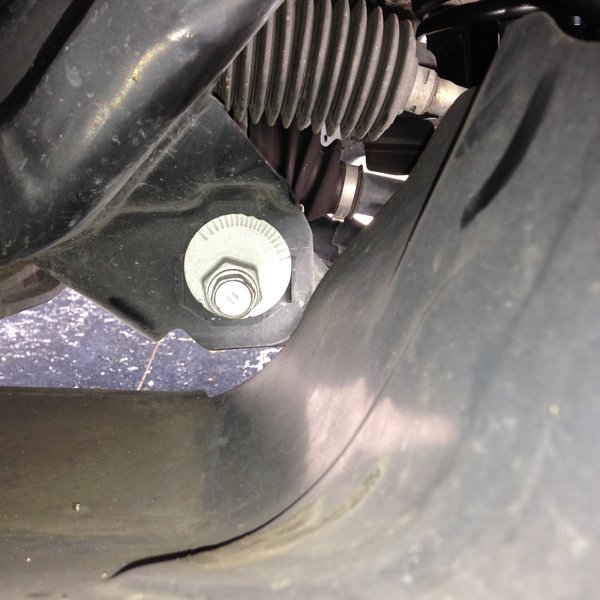

    Hey there, @jberry813
    If you don't mind offering your opinion, what do my eccentrics tell you?
    The tech who did my alignment says he can't get my caster higher than 2.7
    I've just had King extended coilovers and Total Chaos UCA's installed on my 2016.

    Your tech sucks

    Can you elaborate at all? I will not be taking it to the same shop again, but if I could offer some pointers to the next guy, that would be helpful.
    I read your (amazing) write-up on how to do an alignment at home, but if you can offer specifics, that I can't see with my untrained eye, that would be most helpful.
    I can't keep paying $100 over-and-over for people to not get it right.
