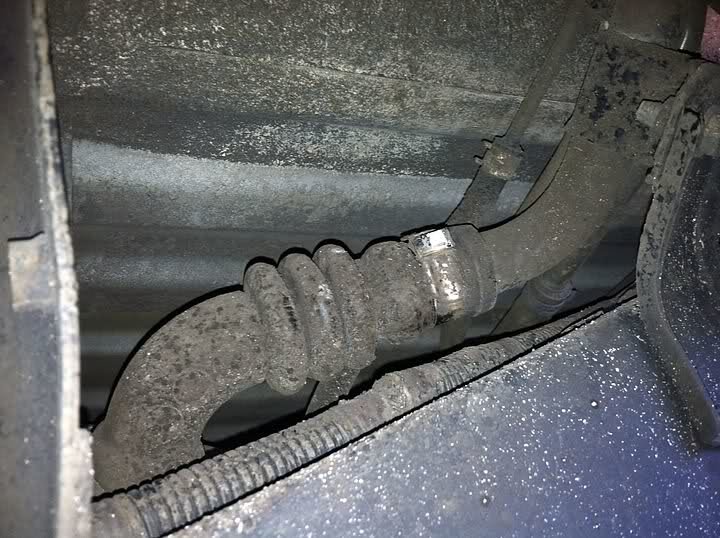

    Okay well, the problem is definitely IN the tank. I removed this flexible rubber elbow right above the tank ...
    .... and dropped a socket down the neck from the top. It fell right through.
    So then I got a little mirror-on-a-stick and with a little help from a flashlight I was able to look down into the tank and I could sure enough see something that looked like it was blocking the hole.
    I don't think it was the little trapdoor thingy. It did look look disc-shaped, but it looked slightly bigger than the tank neck, like it was inside the tank to begin with. At any rate I stuck a big screwdriver in there and jammed it down into the tank. At that point I could neither see or feel anything else that might be a problem, so I put it all back together and went to the gas station with high hopes.
    But ... I'm still screwed. Nothing's changed.
    I guess I gotta remove the tank and see what's up?
