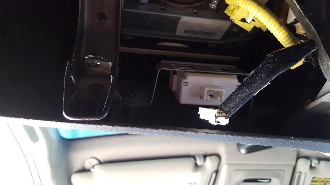

    Here is a picture of the receiver (unplugged). I cannot get into programming mode either. Still after unplugging and thumbnail.jpg plugging in I still cannot get into programming mode!

    I just finished unplugging and plugging back in my little white box and I finally got it working after about 2 weeks of messing with trying to program my key fob! I found that it's not enough to follow the procedure correctly but you also have to time every step right too.
    I followed this guy step for step and second for second and it worked the first try.
    https://youtu.be/_ZOwhaqcQkY

    I tried all the tricks here. Even unplugged the unit above the glove box. Still didn’t get into programming mode, UNTIL I did the following.
    My Tacoma is a 2006, so the key is pretty worn out. My key had some slop in the ignition. I had actually hold the key UP while I inserted it. I would wait each time until the door chime would “ding” twice, then take the key in and out as per the process. Then it finally worked!
    So if you’re having a hard time getting into programming mode, try holding your key “up” while it goes in and out, and when you keep it in and close the door.
    Cheers!!

    I did all this and it still did not work. tried it many many times. Then I removed the negative and positive battery wires from the battery, waited 5 minutes and the re connected it. Then I unplugged wire from box behind glove compartment and plugged it back in. then I followed the programming instructions and it finally worked this time. If your like me and cant get it into programming mode try this. it fixed mine.
