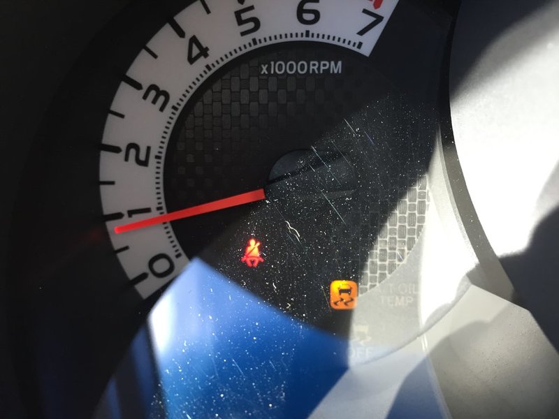

    Hey guys. I just got an alignment done after installing a lift and the Slip Indicator light is on and isn't going off when I press either the A-Trac button or the VCS off button. Any ideas?

    That is vsc light and you need to recalibrate the yaw sensor. There are threads on here I am on my phone and can't find it right now but there are directions to reset it. One thing I learned is the instructions have you jumper out 2 pins on your obdII connector, but I had to clear the old ones by tapping the jumpers together 4 times then recalibration. Search for vsc recalibration and the thread should pop up with instructions though. If I get a chance later I will try to find it.
