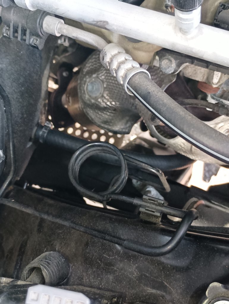

    Its fine, I torqued with wrench and no more dealership free service left anyway, so i wont have hard time getting it off next time. I almost broke the plastic housing, like last time after dealership tightened it so much that i couldn't get it off and needed pneumatic.
    Its nice outside so I think i will do AC drain mod now, i have the materials already

  5. Jun 20, 2025 at 10:15 AM
    #25
    Tacosauro
    Tacosauro [OP] Well-Known Member
    Jun 8, 2024
    #451119
    616
    23 SR5 V6 & 24 TRD OR
    roof rack
    Is this good? its touching some cables, but not touching manifold

    Yep. Throw a zip tie on it if you're worried or just in case it shifts. I forget where I loosely tied mine to.
    Glad you're off the dealership service and doing your own work!
