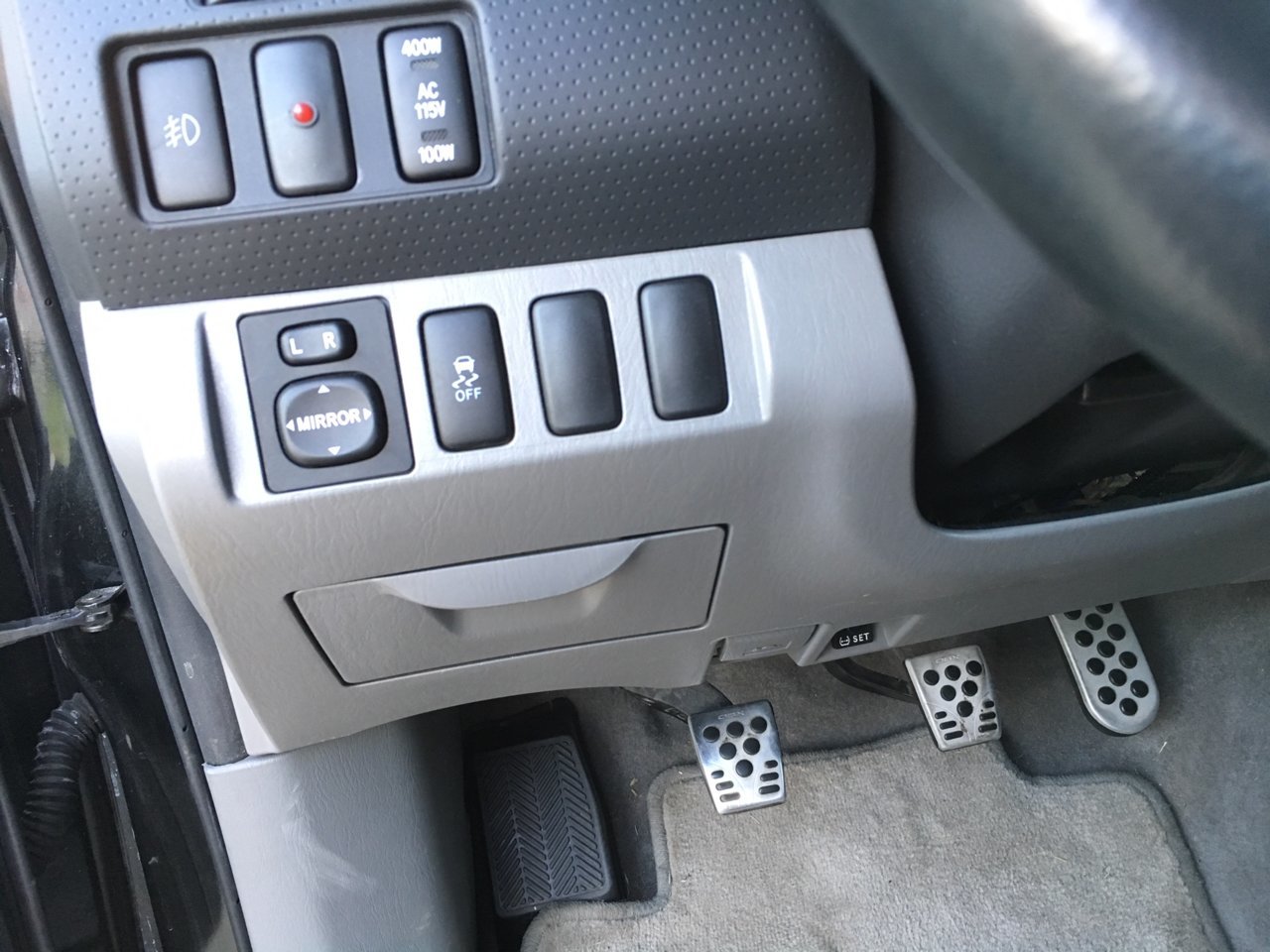

    I don't see any red blinking lights. I'll try unplugging it tomorrow.

    It looks like the red light between the fog light switch and the power inverter switch. That is probably the aftermarket security LED.

    Then find the 'brain' may have dip switches. Get the manu number off of it and get the docs. May have to lookup and call alarm manu.
    Installers are lazy look for a box around steering column under the dash, fuse box under the dash or firewall by pedals.
