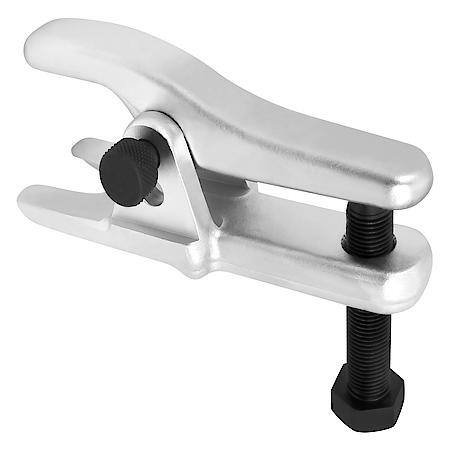

    I won’t revisit it on the truck now, but that looks like the one I bought from HF. It fit perfectly on the lbj, but I recall it was a non-starter for the tre.
    I remember @Timmah! using a smaller size from an otc kit in one of his videos for the tre. That’s what I thought I had rented, but couldn’t make it work. Next time I’m wrenching I’ll give it another go with the HF one that I bought.

    The above tool is the one i use it works great for me!1
    To me When it is time for Ball joints time for outer tie rods as well .
    In that case pickle Fork on the Air Hammer for the Win.
