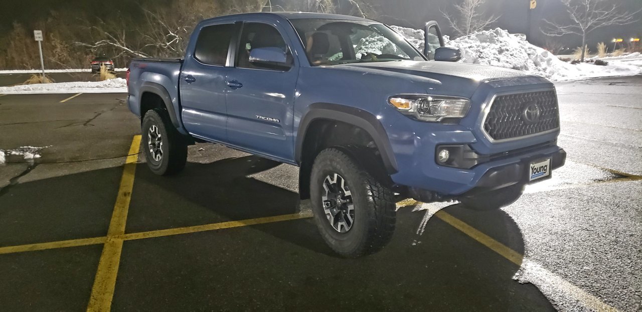

    Tacoknife and Rockoma5 [OP] like this.

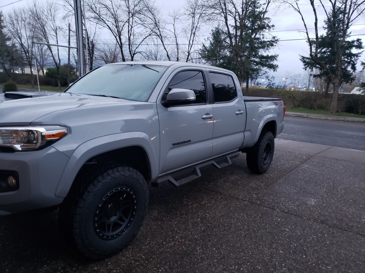

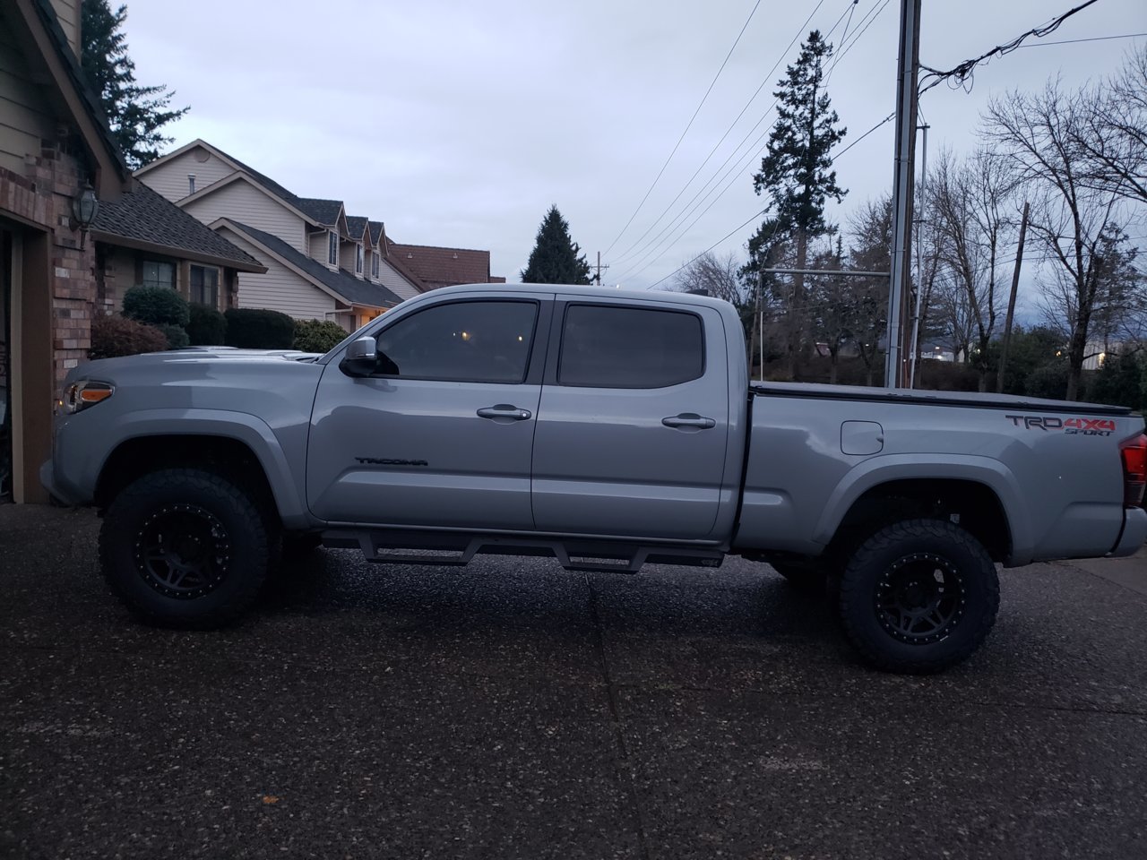

    2018 TRD OR with a stage 6 icon 3” lift running on 285/70R17s. I still use dynamic cruise every road trip. All other TSS features also seem to work without recalibration. You’ll be fine!

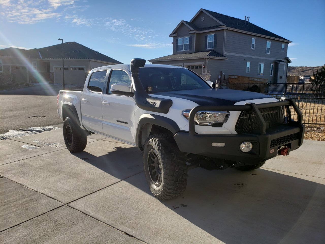

    2018 Tacoma DCSB Off-Road
    *ARB Summit Bumper *Warn Zeon S10 Platinum *Kings adjustable front and rear *Safari snorkel *17" Fuel Vectors *285-17r17 BFGoodrich KM3 *Rigid Industries ditch lights and a 30" bar *Custom grille *Spod *Cobra handheld CB *Yaesu FTM-400XDR, PulseLarsen NMO2/70B, NMO mag mount *Snugtop Rebel Topper
    Mine also works just fine.. 2018 running 285/70r17 with 3" left. I'm also having no issues with my bumper installed. Save the money and install it all yourself. My floor jack was my helping buddy!

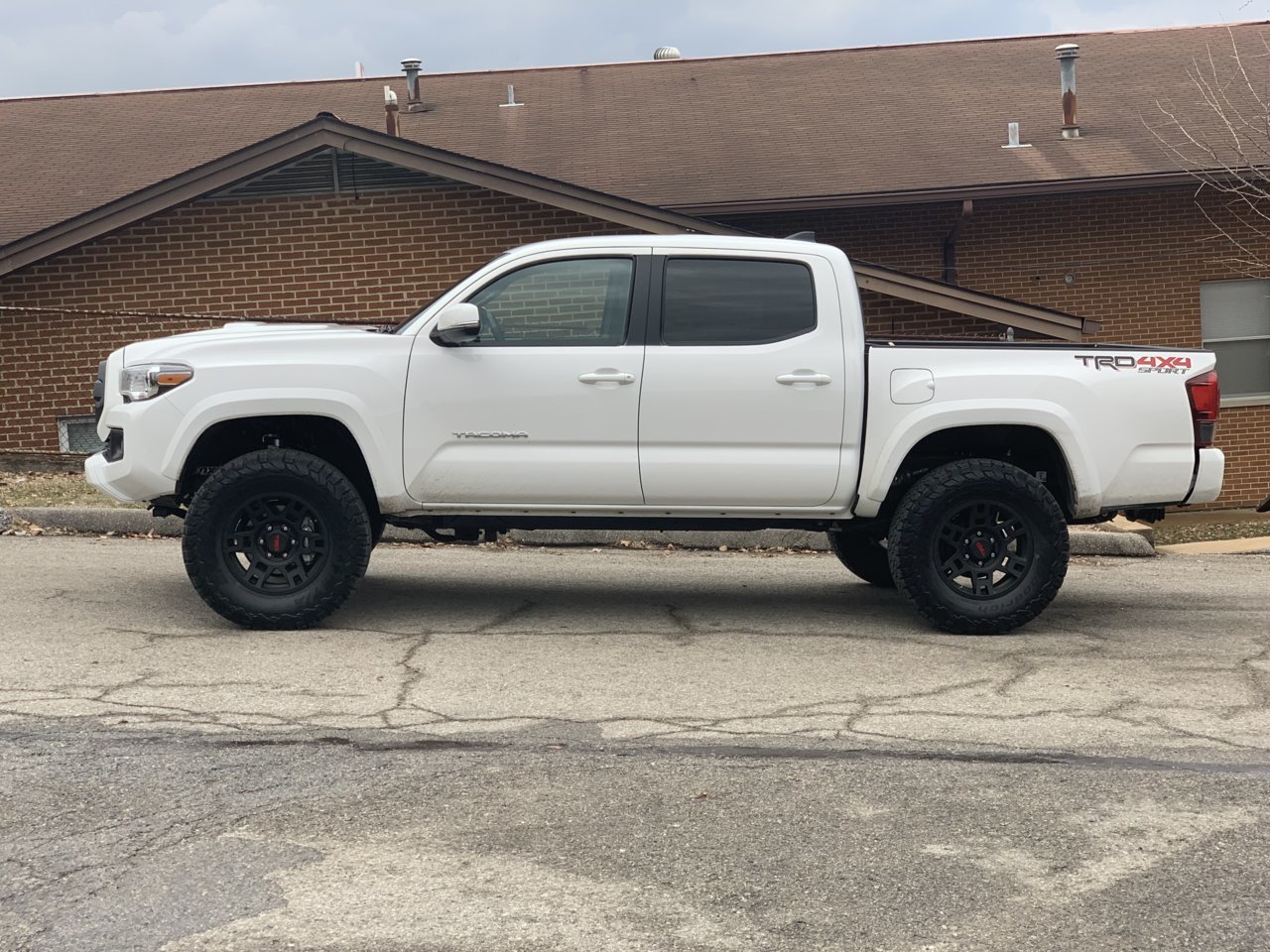

    Go thing you can lift them. I am thinking of selling my New/older Pro suspension, meaning 2015 and under pro, that I bought when they were on close out and my rims and tires.
  17. Feb 10, 2019 at 6:26 PM
    #57
    Rockoma5
    Rockoma5 [OP] Well-Known Member
    Sep 19, 2014
    #138625
    268
    St Louis
    2019 TRD Sport Lifted
    82DAACE4-621A-4A8B-ACE3-F4BD97C47DED.jpg 21E014BD-3C8B-402D-883E-964D72AB8C89.jpg
    Cl4aub likes this.
  18. Feb 10, 2019 at 6:26 PM
    #58
    Rockoma5
    Sep 19, 2014
    #138625
    268
    St Louis
    Forgot to upload. 2nd pic is after a realignment and a little more coil over adjustment for a bit more lift.

    Rockoma5
    Sep 19, 2014
    #138625
    268
    St Louis
    Ended up buying 2019 TRD SPORT and doing 3 inch Fox Lift with 33s
