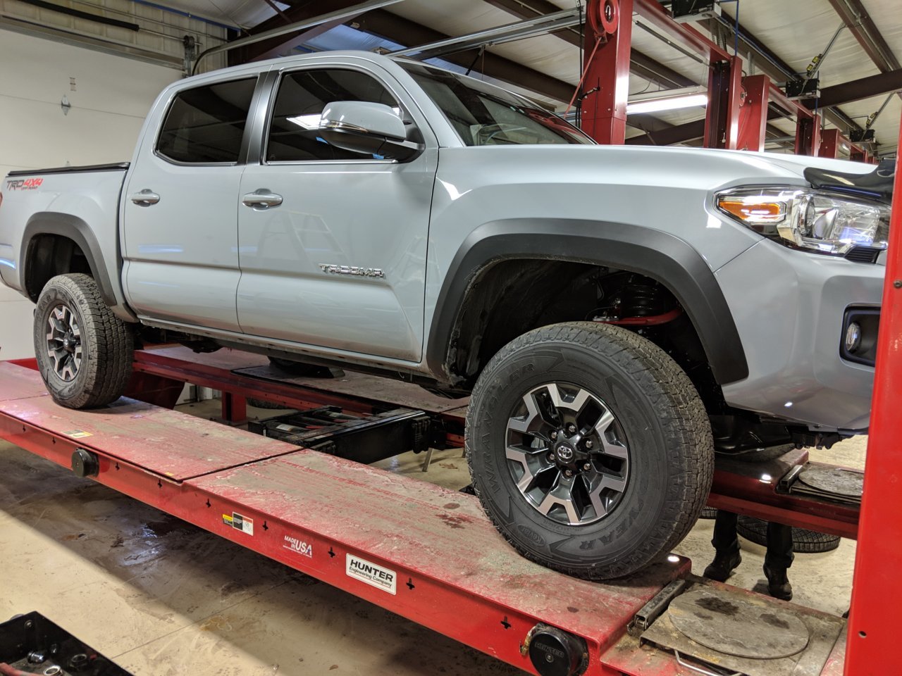

    Bilstein 5100/OME 888 on front, Dakar Medium Duty Rear, JBA UCA'S
