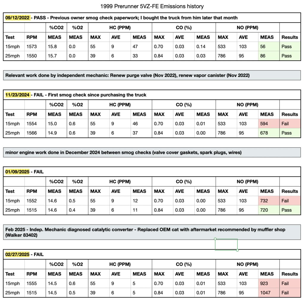

    I'm gonna take the truck into a STAR smog repair tech to get it diagnosed, but I'd like some guidance so I at least have the vocabulary to talk to the tech about it. I've failed 3 times, and replaced my catalytic converter at the advice of a mechanic (not a smog specialist) who claimed everything else checked out so it "had to be the cat". NOx reading was substantially worse after replacing the cat. So I'm out almost $1k and have nothing to show, but I'm sitting on a fix-it ticket for expired tags so it's gotta get handled somehow.
    Truck is a 1999 Prerunner, 5VZ-FE. I've read these engines can have an EGR system but I can't visually see anything running from the exhaust manifold to the intake and my smog paperwork says EGR Not applicable. As far as I can tell, O2 sensors have never been replaced (I know that's probably the next step).
    Numbers attached:

    1st test on 11/23/24 I drove straight from home, pretty much no warm-up, about 1.5 miles to the smog station. Shut the car off for about 20 minutes while I waited.
    2nd test on 01/09/25 I drove about 40 miles (stopped at a different station along my commute). I think I let the truck idle while I waited, can't remember for certain.
    3rd test on 02/27/25 I drove about 40 miles (same deal) the day after I got my cat replaced. Again, can't remember if I let it idle or not while I waited.
    What's the optimal strategy in terms of running temp/cat temp? Should I get it nice and warm and make sure I'm idling before the test?
