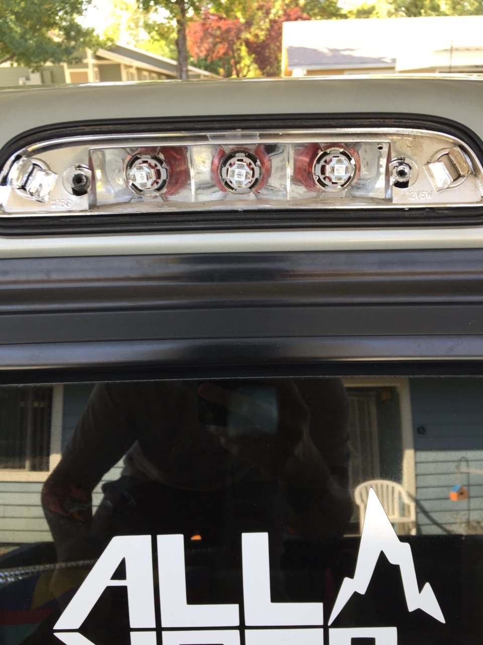

    Shouldn't I be able to pull out the bulbs in the 3rd brake light? I can't. Does someone have a special technique to pull these bulbs out?

    Just 194 bulbs right?

    I think they're 168.

    Yep. They pull right out. Maybe wiggle them as you pull.
    I added LED’s to mine.

    I wiggled them. Finally, I used a small screw driver and pried it out from the side.

    a little CRC in the sockets really helps them to be removed and not corrode.

    Bulb grease on the end will keep that from happening. 2 bucks at any auto parts store basically die electric grease.

    Used CRC before I pulled them out. Then on re-install I used CRC again.
